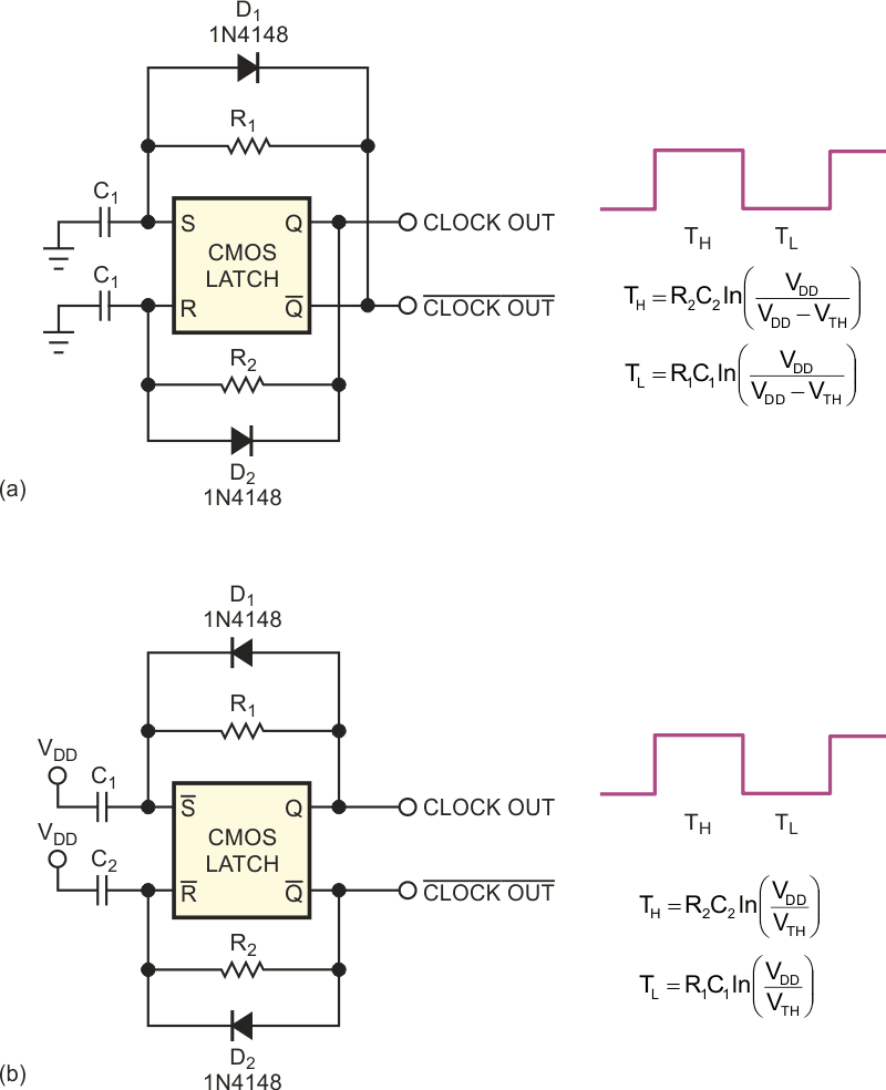

Connecting two RC networks between the complementary outputs Q and /Q and set and reset inputs enables astable operation (Figure 1). Due to complementary outputs, the circuit has no stable state, and it toggles continuously, generating an output clock.
| Figure 1. | Capacitors that connect to ground or VDD depend on active-high (a) or active-low (b) inputs. |
The time constants R2C2 and R1C1 set the high and low time periods, TH and TL, respectively, and also the duty cycle. Diodes D1 and D2 quickly discharge capacitors C1 and C2 so that, on the next cycle, they will recharge from 0 V.

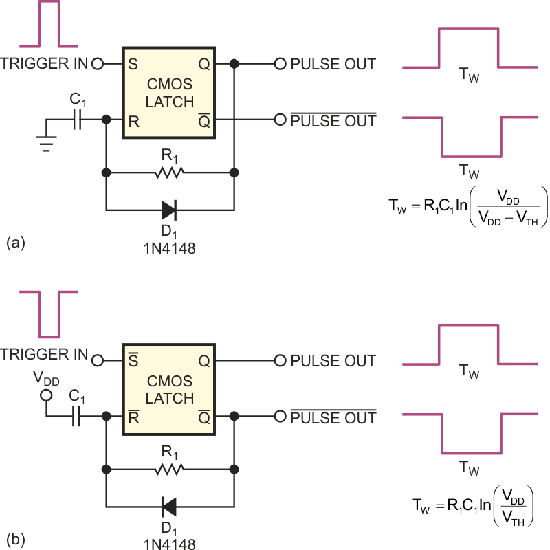

In monostable mode, connect one RC network (Figure 2), depending whether you need a positive-pulse or a negative-pulse trigger. When an input trigger pulse occurs, it sets the output pulse, TW, which remains in this state until the RC network activates the reset pin. The RC time constant sets the output-pulse width. For correct operation, the trigger pulse must be shorter than the output pulse. Diode D1 reduces recovery time.
| Figure 2. | The leading edge of the trigger pulse depends on active-high (a) or active-low (b) inputs. |
The threshold voltage has the typical value VDD/2, but it may change from 0.33 to 0.67 of VDD for the CD4000 CMOS family. The parameters of the generated output signals of the circuits in figure 1 and figure 2 present variations from unit to unit as a function of threshold-voltage shift. On the other hand, the threshold voltage presents good stability with supply voltage and temperature variations.
