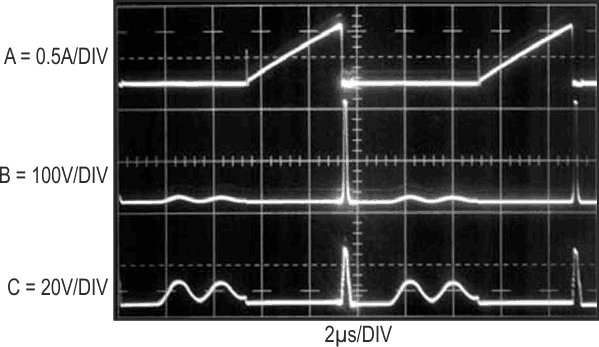

Waveforms for 5 V to 200 V converter include LT1172 switch current and voltage
Figure 2. Waveforms for 5 V to 200 V converter include LT1172 switch current and voltage
(traces A and C, respectively) and Q1’s drain voltage (trace B). Current ramp
termination results in high voltage flyback event at Q1 drain. Safely attenuated
version appears at LT1172 switch. Sinosoidal signature, due to inductor ring-off
between current conduction cycles, is harmless. All traces intensified near center
screen for photographic clarity.
Figure 2 shows operating waveforms. Traces A and C are LT1172 switch current and voltage, respectively. Q1’s drain is trace B. Current ramp termination results in a high voltage flyback event at Q1’s drain. A safely attenuated version of the flyback appears at the LT1172 switch. The sinosoidal signature, due to inductor ring-off between conduction cycles, is harmless.
