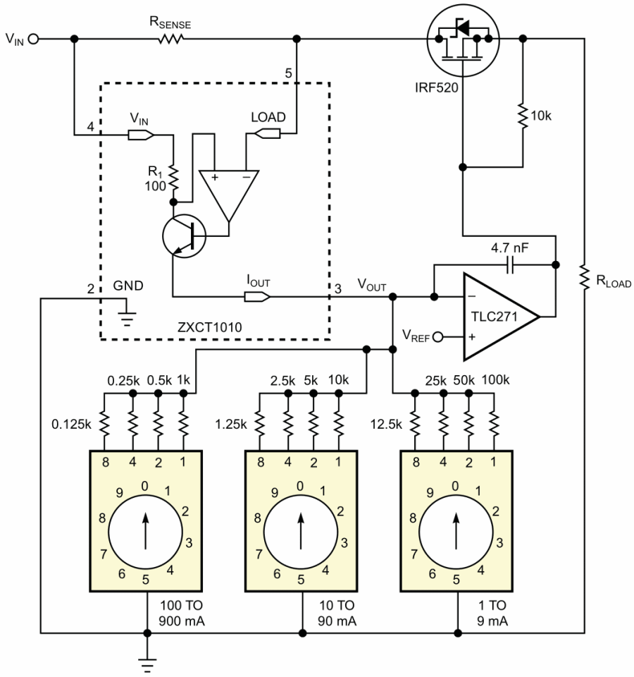

A previous Design Idea describes a programmable current source that used a three-terminal LM317 adjustable regulator (Reference 1). Although that circuit lets you program the output current, the load current flowed through the BCD (binary-coded-decimal) switches. However, you may find it difficult to purchase BCD switches that can handle more than 25 mA, limiting the circuit’s output current. By applying the simple, four-pin ZXCT1010 current-sense-monitor chip, you can boost current because it doesn’t flow through BCD switches (Figure 1). The load current results in a voltage on the sense resistor RSENSE.
| Figure 1. | Passing current through a MOSFET and regulating it with a current-sense monitor bypasses the BCD switches, letting you increase load current. |

You can apply the output voltage as a control voltage to regulate the load current.
One application for this circuit would be to refill accumulators in portable devices. In this case, the circuit works at 18 V. The IRF520 is an N-channel, power-MOSFET chip in an aluminum heat sink with as much as 9.2 A current and 0.27 Ω drain-to-source resistance to connect the load current. An op amp controls the IRF520 in the feedback of the load current. In this application, the maximum output current is 1 A, and the value of the sense resistor is 0.1 Ω. The PCB (printed-circuit board) can also have this small resistance value, which you calculate using the cuprum material’s 35-micron-thick layer. The BCD switches are in parallel and connect from 125 Ω to 100 kΩ to adjust the output voltage on the op amp’s negative input. The equations to calculate resistor values are:
and
If you choose a value of 0.1 Ω for the sense resistor and a value of 0.1 V for the reference voltage, the equation becomes
Applying this equation, you can calculate the four weighting resistors of the three BCD switches, which you can determine when the current flows through only that resistor. For currents of 800, 400, 200, 100, 80, 40, 20, 10, 8, 4, 2, and 1 mA, the corresponding resistances would be 0.125, 0.25, 0.5, 1, 1.25, 2.5, 5, 10, 12.5, 25, 50, and 100 kΩ. If the load current is 1 A, then the output current is only 1 mA, and, if the load current is 1 mA, then the output current is only 1 μA. Note that the IRF520’s surface is on the drain potential.
