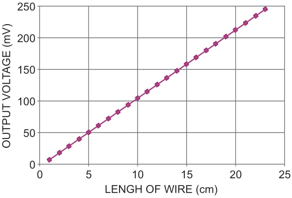

| Figure 2. | The output voltage of the system for various lengths of 18 AWG copper wire has a resistance of 213.58 μΩ/cm, as measured in the laboratory |
The output voltage of the system is linear over the entire range as can be seen in Figure 2.

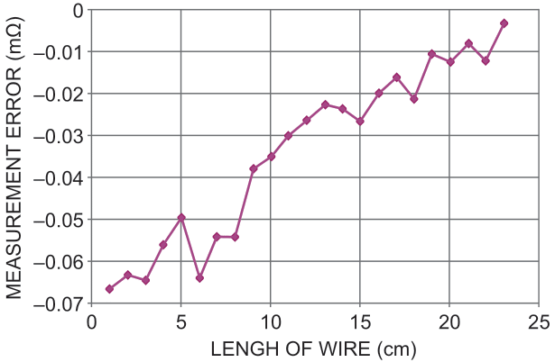

Figure 3 illustrates the measurement error of the system. The linearity of the system is further demonstrated by Figure 4.

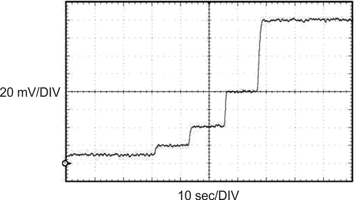

| Figure 4. | The linearity of the system is demonstrated by the output voltage of the system as the measurement leads are placed across 1, 2, 4, 8, and 16 cm lengths of wire. |
