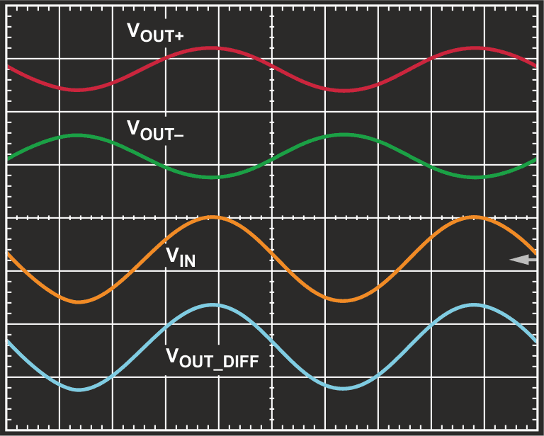

An oscilloscope plot of the output waveforms is shown in Figure 2. Both in-amps are in a gain of 1 VIN is a 1 V pp 10 kHz sine wave riding on a large common-mode voltage. VOUT+ and VOUT– are ±0.5 V pp sine and cosine waves. VOUT_DIFF is the differential output voltage of 1 V pp, which is just VIN with the common mode removed.
| Figure 2. | The performance of the circuit: Top: two complementary outputs, Middle: input voltage with large common mode, Bottom: the differential output. |
