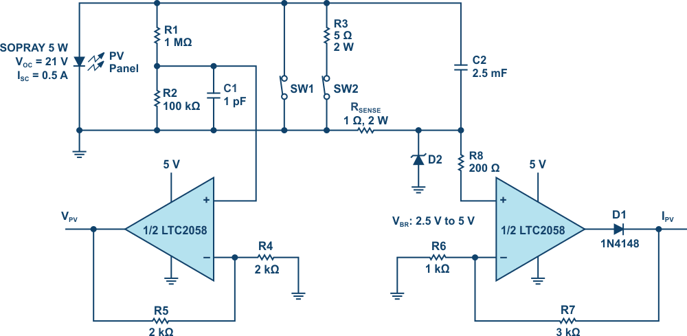

Figure 1 shows an implementation of the I-V sweep approach to characterizing a PV module. C2 is the main capacitive load, where its size is a trade-off between measurement speed and accuracy: a smaller C2 sweeps faster, reducing the risk of error; a larger C2 sweeps more slowly and allows for more precise sampling of the measurement.
| Figure 1. | PV sweep measurement with the LTC2058. |
In the initial state, both SW1 and SW2 are shorted, so there is no voltage across C2. Both switches must be thrown open, first SW2 and then SW1, to start a measurement sweep that lasts 150 ms, ending with the full voltage of the module across C2. Discharging C2 after the measurement is done in preparation for the next cycle involves first throwing SW2 closed, where the 2 W rated R3 in series reduces the risk of sparking, and then throwing SW1 closed to provide a true short (RON = 0.3 Ω) across C2 and bringing the voltage across C2 to 0. For the purpose of full-system implementation, these switches can be power MOSFETs driven by digital signals that control the timing and sequence of switching.

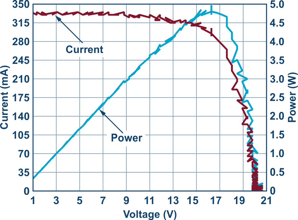

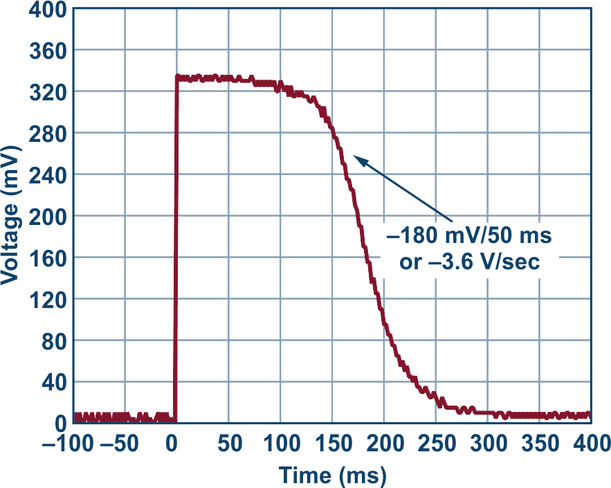

The LTC2058’s robust 2.5 MHz gain bandwidth product is crucial for precise tracking of the sweep rate of the PV current through RSENSE. The greatest current sense measurement error occurs midway through the sweep cycle during the steepest transition. Although the input voltage across RSENSE has a relatively low falling slew rate of 3.6 V/s (see Figure 2), the group delay of the op amp translates to real-time error in the current sense output. Also, since RSENSE is fairly large, the closed-loop gain for the current sense circuit can be as little as 4 V/V to produce a 2 V full-scale output at the maximum short-circuit current (ISC) of 0.5 A. This low gain is not a problem due to the LTC2058’s unity-gain stability. Thus, the LTC2058’s high gain bandwidth and low closed-loop gain requirement allow for a fast closed-loop response, minimizing the error due to group delay.
| Figure 2. | Voltage across sense resistor with a slew rate of about 3.6 V/sec. |
The large capacitor C2, in conjunction with large RSENSE, determines the slew rate of the transition and thus the error due to a fixed delay. The trade-off of a larger C2 is that the I-V measurement takes longer.
The diode D1 allows the output of the current sense channel to swing all the way down to 0 V to measure the exact current at the open-circuit condition at the very end of the sweep cycle. Diode D2 and 200 Ω resistor R8 help protect the current sense amplifier’s IN+ from electrical overstress.
| Figure 3. | I-V and power-V curves taken with capacitive sweep and LTC2058 circuit. |
For the voltage sense channel, R1 and R2 divide down the full voltage of the module so that the output at VPV, after a closed-loop gain of 5 V/V, is within the 5 V supply rail. R1 and R2 can be adjusted to divide down any module open-circuit voltage (VOC), as long as they do not consume an appreciable amount of current relative to the module ISC. In this design, current through R1 and R2 contributes an error of 19 µA, or 0.0038% of ISC.
