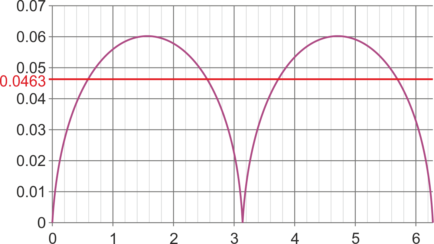

This makes Q1 generate a PTAT (proportional to absolute temperature) AC signal equal to °K/5050 volts peak-to-peak that follows the 120-Hz log(|sine|) waveshape shown in Figure 2.
| Figure 2. | Q1’s ∆VBE PTAT log(|sin(r)|) °K/5050 waveform. (Yaxis = volts, Xaxis = radians Red = average value = AC baseline). |
The PTAT signal Vpp is boosted by A1a’s gain = –2,742,160/R1, then compared by A2 to its precision (2.50 V ±0.4%) internal shunt reference (thanks again, Konstantin Kim, for finding the versatile AP4310A!).
