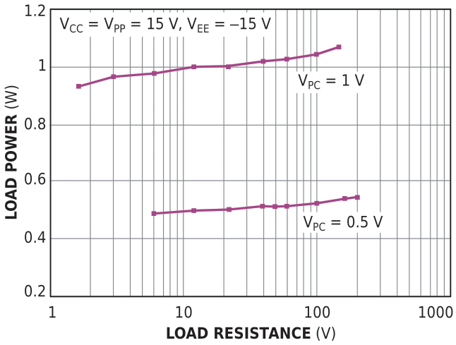

| Figure 2. | Power delivery to the load is nearly independent of load resistance. |
Curves for load power versus load resistance for 0.5 and 1 W loads show that power delivered to the load changes less than ±7% for a change of 10,000% (two decades) in load resistance (Figure 2). If you define load regulation as the change in output power divided by the output power, then for a load change of 6 to 40 Ω at 1 W, the load regulation is ±2%. For the circuit to work properly, you must calibrate the analog multiplier as Motorola's MC1495 data sheet delineates. You repeat that calibration procedure below for convenience. Remove jumpers J1 and J2 for the calibration.
