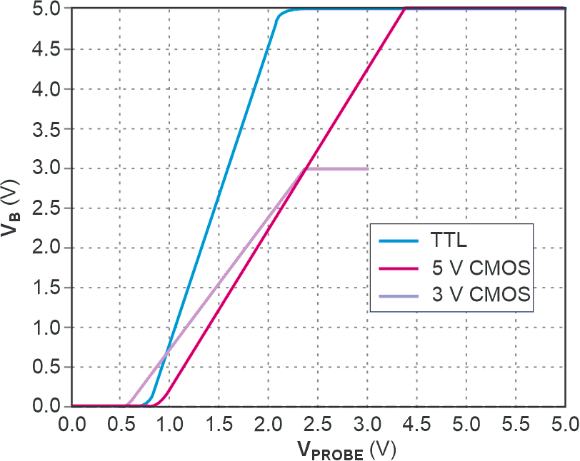

The output voltage transfer function of IC1B is
which makes VLED = VB – 2.5 V. The values of R6, R7, and R8 are such that VB limits at the positive or negative power-supply rail when VPROBE is at the logic family’s minimum low or high level, respectively. Figure 2 shows the voltage- transfer function for VB. When VB limits at the rail voltage, the LED lights red or green, depending on the probed logic level. When VB is within 0.5 V of the negative rail, the red LED turns on; when VB is within 0.4 V of the positive rail, the green LED turns on. If the probe measures a high-impedance state, voltage- divider resistors R4 and R5 set the positive input of IC1B, and the voltage across the LED is approximately 0 V.
| Figure 2. | The output of IC1B, VB, limits at either the positive or negative supply rail depending on the probe voltage. |
