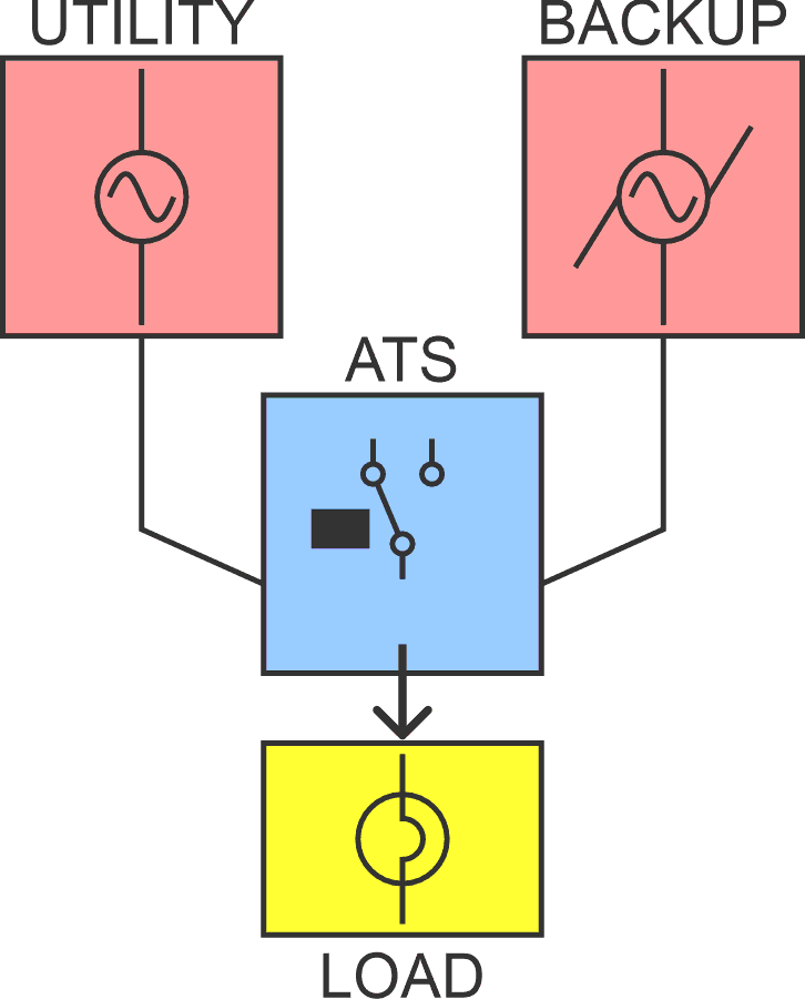

An ATS is a clever piece of hardware that automatically shifts the electrical load from your primary power supply to a backup or standby source – like a generator – when it detects an outage. The result? A stable, uninterrupted power supply that keeps critical appliances and operations humming along. In Figure 1 is a quick visual to help you understand the system better.
Here is how an ATS shifts the electrical load from primary power supply to a backup or standby source.
Figure 1. Here is how an ATS shifts the electrical load from primary
