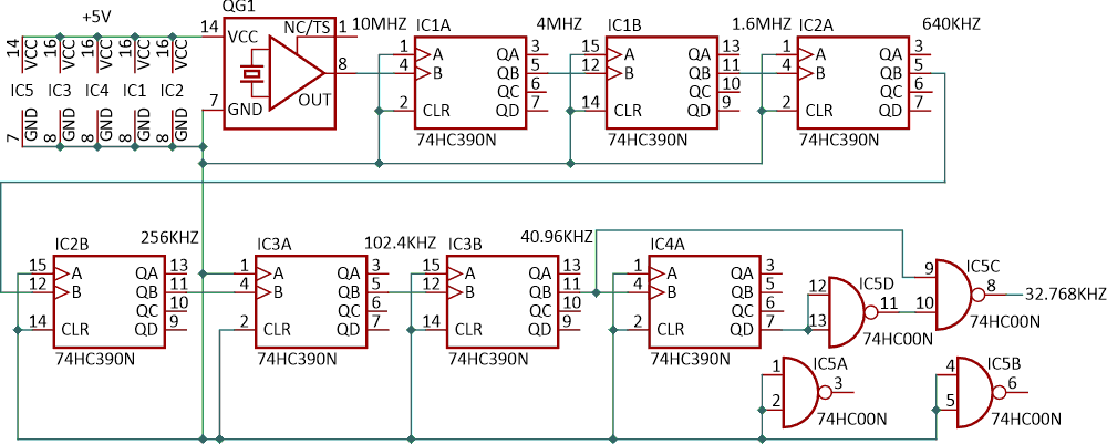

Implementation
The complete divider schematic is shown in Figure 1. QG1 is a 10 MHz crystal oscillator module, which could be a high stability OCXO if required. It provides a TTL compatible clock to the first divide-by-2.5, IC1A. Input A is the clock input of the 74HC390’s divide-by-2. In this case, A is unused so it is tied low, while QA, its corresponding output is left floating. Input B and outputs QB, QC and QD form the divide-by-5 with QB the LSB output.
Schematic diagram for divider chain.
Figure 1. Schematic diagram for divider chain.
QB of IC1A produces a 4 MHz clock which is then further divided down to 1.6 MHz by IC1B. IC2 and IC3 divide this further with divide-by-2.5 stages to 40.96 kHz. IC5C from a 74HC00 quad dual input NAND gate inverts the QD output of IC4A. This is fed to a NAND gate where it AND-ed with the incoming clock to form the divide-by-1.25 resulting in a 32.768 kHz clock at its output – pin 8.

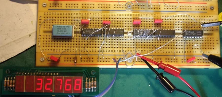

To verify the theory, the circuit was prototyped on a breadboard as shown in Figure 2.
Breadboard implementation of divider chain with frequency counter.
Figure 2. Breadboard implementation of divider chain with frequency counter.
The 10 MHz reference (QG1) is the metal canned oscillator module on the left-hand side. The four 74HC390s are next to that, with the 74HC00 on the far right of the proto board. The display shown just below the prototype is a ICM7216D based frequency counter, used to display the circuit’s output frequency.
Practical results
The frequency counter in Figure 2 was configured with a one second gate time, during which the irregular pulse train was be smoothed. It used the same 10 MHz crystal oscillator as the divider chain for its reference. As anticipated, its display shows that the average output frequency is the 32.768 kHz specified by the design.

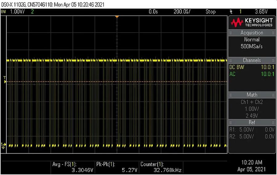

The divider circuit’s output pulse train was also recorded on a Keysight DSO-X 1102G oscilloscope as shown in Figure 3. The average frequency was measured with the internal counter and shown to be 32.768 kHz too. Also note that the irregular nature of the pulse train is clearly visible on the oscilloscope’s display.
