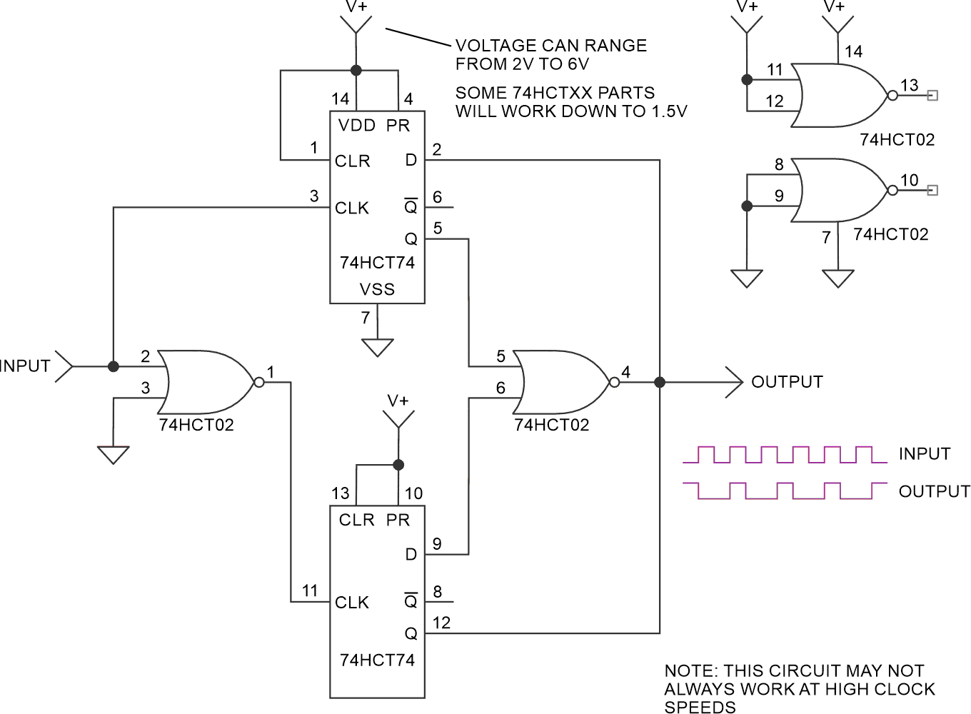

Two inexpensive ICs divide a TTL clock signal by 1.5. By following the circuit with another flip/flop, you could also generate a divide by three function.
Circuit forms divide by 1.5 counter
