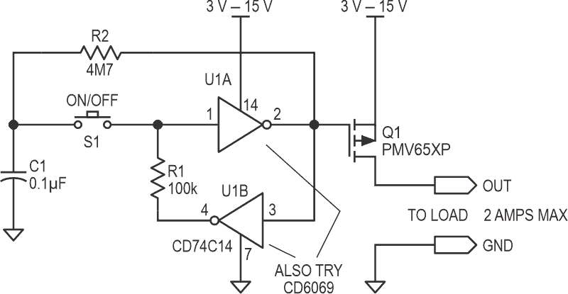

On/off latch circuit
Nexperia 74HC14D
Often you want to turn on and off power to a device with a single pushbutton switch. The circuit below performs this logic function with just a few parts and can operate from DC supplies between +3 V to about 15 V. It uses two inverters within a 74C14 or a CD4069 hex inverter package. Each press of the button toggles between the two on/off logic states. The logic output is connected to a PMV65XP p-channel FET. This component should be able to handle 2 Amps of current. The inputs of any unused devices within the IC package should be connected to either V+ or ground.
