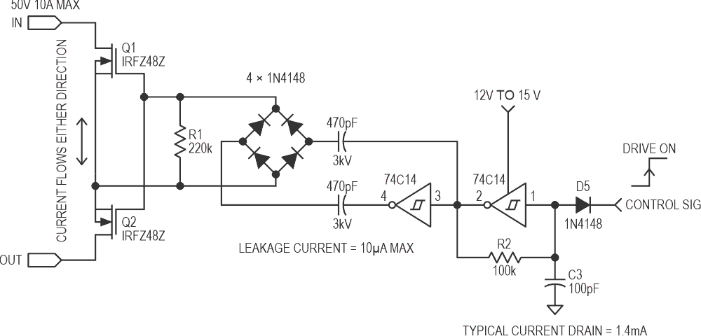

Charge coupled MOSFET relay
Jan 22, 2026
Inchange Semiconductor IRFZ48Z
David A. Johnson
This circuit acts as an AC/DC relay with a rating up to 50 volts peak and up to 10 Amps of current. The differential oscillator supplies voltage to the gates of the two FETs with good isolation will drawing only 1.5 mA of current.
