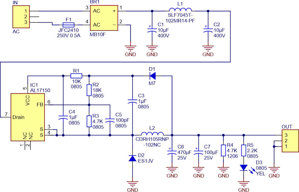

Figure 1 shows the schematic diagram. The heart of the circuit is the AL17150 high-voltage step-down controller chip.
Schematic diagram transformerless 85-260 VAC to 12 VDC-0.2 A power supply.
Figure 1. Schematic diagram transformerless 85-260 VAC to 12 VDC-0.2 A power supply.

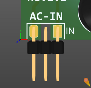

IN is a 3-pin male header, used for the AC input. The PCB board on the middle pin contains a creepage area to follow the high-voltage IPC rules (Figure 2). Similarly, an isolation gap (creepage area) should be created on the mainboard PCB, around the middle pin of the header.
An isolation gap (creepage area) around the middle pin of the header.
Figure 2. An isolation gap (creepage area) around the middle pin of the header.

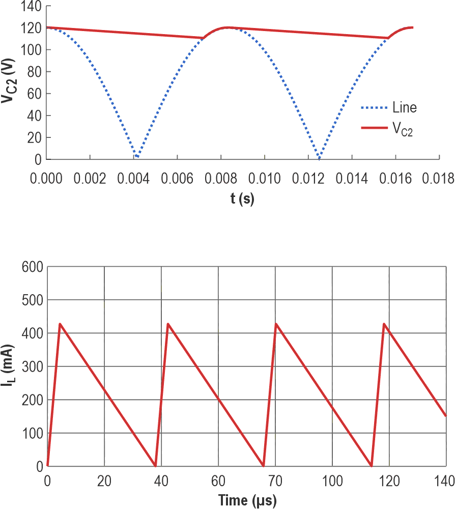

F1 is the JFC2410 250 V-0.5 A fuse for protection. BR1 is the MB10F bridge rectifier, fulfilling the initial stage of AC-to-DC conversion. C1, L1, and C2 build a low-pass Pi filter to reduce the input noise and ripple. IC1 is the AL17150 chip and R2 and R3 are feedback resistors. C5 reduces the high-frequency noises and D2 and L2 build the buck converter circuit. Be careful that D2 is an ultra-fast diode that achieves 35 ns reverse recovery time (Trr). C6 and C7 are output capacitors for noise reduction and output stabilization. R4 is a 1206-4.7K resistor that acts as a dummy load. D3 is a yellow 0805 LED, indicating the output voltage is at a proper level. Figure 3 shows the voltage and current waveforms (simulation) of the C2 capacitor.
Voltage and current waveforms of C2 (simulation).
Figure 3. Voltage and current waveforms of C2 (simulation).

The chip man µFacturer (Diodes Incorporated) has introduced an interesting and helpful Microsoft Excel [1] file that can be used for calculation. If you look at the table, there are a few parameters that you could modify to set your desired output voltage and current. The user sets the FB pin low-side resistor and the high-side resistor is calculated by the script. For the 12 V output, the low-side resister is 4.7K and the high-side one is 18K. The output capacitors are two electrolytic-type in parallel to reduce the ESR, so the total output capacitance is 470 µF + 100 µF = 570 µF.

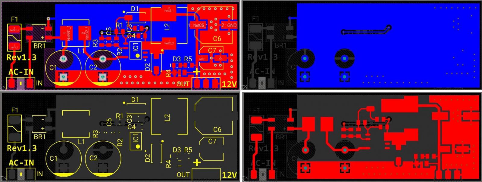

PCB layout
PCB layout of the transformerless 85-260 VAC to 12 VDC-0.2 A power supply.
Figure 4. PCB layout of the transformerless 85-260 VAC to 12 VDC-0.2 A power supply.

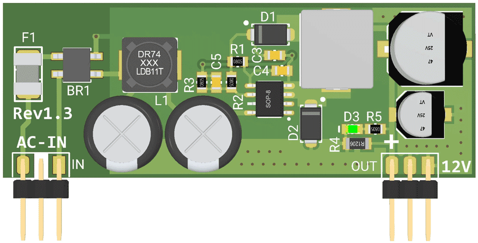

Figure 4 shows the design’s PCB layout. It’s is a two-layer PCB board with SMD components, the design files for which are available in the Downloads section. The smallest package size is 0805, so you shouldn’t have a problem soldering the components using a normal iron and a good tip, although a micro-soldering station is preferred. Figure 5 shows the assembly drawing.
Assembly drawing of the PCB board.
Figure 5. Assembly drawing of the PCB board.

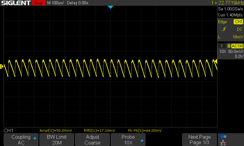

The PCB board has been tested using a DC load, an oscilloscope, and a thermal imaging camera. Figure 6 shows an infrared thermal image of the PCB board after 20 minutes of full operation (200 mA load). The highest temperature was spotted around the controller chip (51 to 52 degrees C) and the room temperature was 28 degrees C. Figure 7 shows the output noise of the power supply, at the maximum output current (around 60 mVp-p). if a lower noise level is expected, you can add one electrolytic (or an electrolytic and a ceramic capacitor in parallel) just next to your load.
Output noise of the power supply (200 mA load).
Figure 7. Output noise of the power supply (200 mA load).
