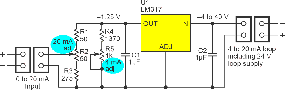

Mr. Ramalingam’s clever solution to the problem of undetected cable cuts is a current transmitter design that adds a third current level to the two that are inherent to an ON/OFF contact. Thusly.
  • 20 mA = contact closed, cable intact
  • 4 mA = contact open, cable intact
  • 0 mA = cable cut, contact state unknown
It therefore explicitly verifies cable continuity, preventing the mistaking of an open circuit for an open contact. See his article (Ref. 1) for details.
0/20 mA to 4/20 mA current loop converter.
Figure 1. 0/20 mA to 4/20 mA current loop converter.

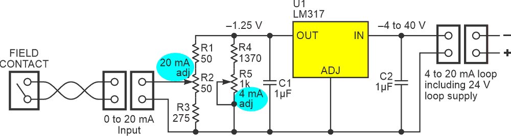

Mr. Ramalingam’s circuit works, is proven, and has nothing significantly wrong with it. Its utility, however, is limited to that single function. It might be significantly more convenient and thrifty if its role could be combined with another in a multipurpose design, provided, of course, that said design would be of no greater cost or complexity than the single-purpose transmitter. Figure 1 and Figure 2 show such a circuit adapted from an earlier article (Ref. 2).
Field contact OFF/ON to 4/20 mA current loop converter.
Figure 2. Field contact OFF/ON to 4/20 mA current loop converter.
Note that the circuits are identical, so that only one design needs to be fabricated, documented, and stocked.
Calibration in this new role is quick and simple and completed in a single pass:
  1. Open contact.
  2. Tweak 4 mA adj for 4 mA output.
  3. Close contact.
  4. Tweak 20 mA adj for 20 mA output.
