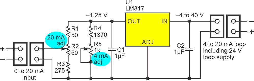

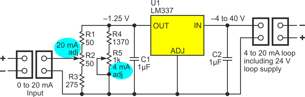

A while back, the design shown in Figure 1 was accepted for publication (Ref. 1).
U1 plus R1 through R5 current steering networks convert a 0/20 mA input into a 4/20 mA output.
Figure 1. U1 plus R1 through R5 current steering networks convert a 0/20 mA input into a 4/20 mA output.

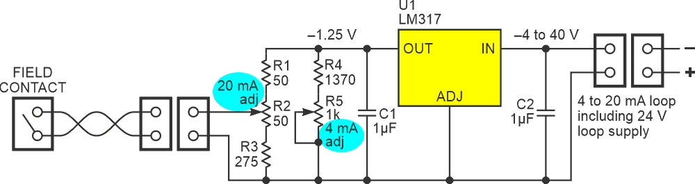

Later, the same circuit, when wired up differently as shown in Figure 2, turned out to be an equally good fit in a different job (Ref. 2).
This 4/20 mA current loop converter integrates an OFF/ON field contact.
Figure 2. This 4/20 mA current loop converter integrates an OFF/ON field contact.

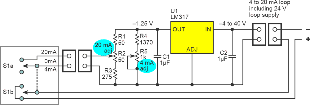

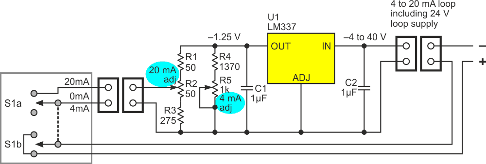

This inspired me to wonder if a different approach to the same calibration problem might also be useful. I imagined a design in which the three standard analog test current loop levels: 0, 4 mA, and 20 mA, were accurately preset and quickly accessed by flipping a switch. I then proceeded to ponder whether that same friendly little converter circuit might work in such an application.
Figure 3 shows the result.
The three-position, center-off, DPDT switch S1 converts this current converter (verbiage redundancy pun-intentional) into a convenient current calibrator.
Figure 3. The three-position, center-off, DPDT switch S1 converts this current converter (verbiage redundancy pun-intentional)
Not only did it fit, but the calibration procedure for the new role is just as quick, simple, and easy to accomplish in a single pass as it was before.
  1. Set S1 to the 4 mA position.
  2. Tweak 4 mA adj for 4 mA output (as measured, for example, with a precision DMM).
  3. Set S1 to the 20 mA position.
  4. Adjust 20 mA adj for 20 mA output (ditto).
So, it turns out that the same circuit thriftily fits three related, yet different, applications – a triple-duty design trifecta.
