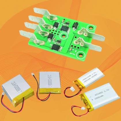

Battery switch
Texas Instruments LM5050-1 LM5050-2 CSD17501Q5A
Given two batteries, it chooses the one to connect to the load based on the voltage measured at their poles. It can also be used to switch DC power supplies.
Battery switch

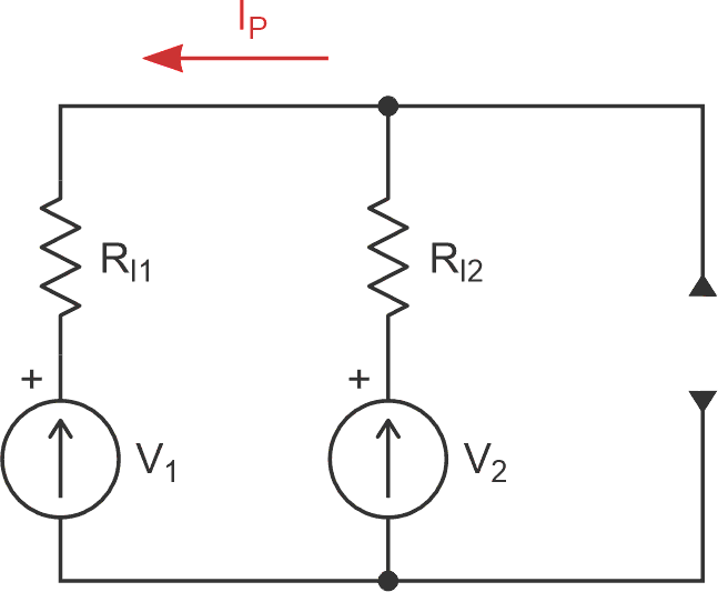

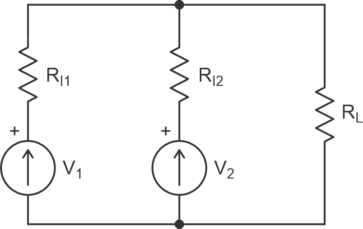

In fact, electrotechnics teaches us that parallel-connecting two ideal generators of different voltage are not feasible because, given the internal zero value resistance, the one with higher voltage would unload an infinite current on the one with lower voltage. Even if the generators are real, the one with higher voltage gives part of its current to the one with lower voltage. Let’s make the concept clearer with Fig. 1, supposing we have a 12.4 V V1 (which internal resistance is RI1) and a 12.8 Vcc V2; we set the internal resistance for the latter (RI2) to be the same of RI1 at 5 mΩ. These generators will feed a load of RL = 4 Ω which will, therefore, absorb around 3 A.
Generators with load.
Figure 1. Generators with load.
However, even without a load (as shown in Fig. 2), we can already notice that V2 will supply V1 with a voltage of:
Therefore a good amount of the energy is wasted on the internal resistors of the generators, which will dissipate a PP power equal to a:
while the load will absorb around 36 W, and that means a loss of around 30%.

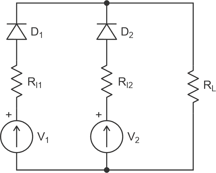

You can then see that the batteries in parallel issue are not trivial. The first thing that comes to mind in order to solve the issue is to use two diodes, as shown in Fig. 3; this way, the battery with higher voltage will power the RL load until it discharges and reaches the level of the lower voltage battery, then the latter will start supplying current. In case of equal voltages, like voltage drops on the two diets, the two batteries will provide current in parallel; everything apparently works smoothly; there are no high currents circulated, not even if the difference between V1 and V2 is sensible and the difference between RI1 and RI2 very small.
Parallel connection of generators using diodes.
Figure 3. Parallel connection of generators using diodes.

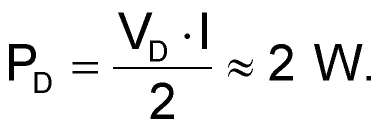

However, the problem is the voltage drops on the diodes, amounting to 0.6 – 0.7 V for the PN diodes and 0.2 – 0.3 V for the Schottky diodes. To the voltage drop on the junction, we must add the drop on connections for the diodes capable of withstanding high currents, called bulk resistance; therefore, in a diode capable of withstanding 5 – 10 A it is not unusual to see a voltage drop over 1.1  – 1.2 V.
For this reason, the RL load will receive lower voltage then the generators and a power proportional to the voltage would be dissipated in the diodes. Supposing that each generator supplies an equal amount of current, using the values from the previous example we would have, on each diode, a dissipation of around:
If now the load is powered by
V1 = V2 = 12 V
it will receive
VL = V – VD = 11 V
and power on it will be around 30 W. Since losses are around 4 W, the efficiency of the system showed in Fig. 3 would be around 87%. In order to have a low loss commutation, we must look for alternative solutions, e.g. the one described in these pages.

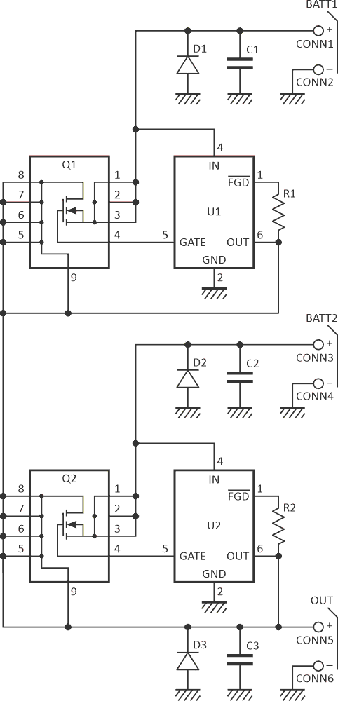

Circuit diagram
The circuit in Figure 4 we are proposing is an automatic battery switch made with power MOSFETs with very low RDSON, which are specifically for SMD but are capable of withstanding noticeable currents since they have very low resistance when adequately polarized. Therefore, these devices are very fitting to act as power switches.
The circuit of the automatic battery switch.
Figure 4. The circuit of the automatic battery switch.

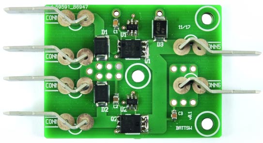

External appearance of the automatic battery switch.
Figure 5. External appearance of the automatic battery switch.
The appearance of the switch is shown in Figure 5, and the list of components used is given in Table 1.

The component employed is a CSD17501Q5A by Texas instruments, capable of withstanding a 30 V VD and a 100 A IDS; the resistance between its drain and source under ON conditions is just 2.4 mΩ.
If we go back to the previous example, the voltage drop for a 3 A load is just 21.6 mV, which is the power dissipation on the most that, for the usual 3 A transit current it is about 65 mW while for a diode, we saw that could be around 4 W. By using to MOSFETs to switch generators on the same load, therefore, the efficiency of this switcher nears 100% (99.82%); besides, the voltage on the load will be basically identical to the generators.
So we have found the ideal actuator, however, in order to carry out our task, which is to create an automatic battery switch, we need a control logic capable of alternately connecting either of the generators with the single load, just like we had tried to do with a couple of diodes. This control system of the MOSFETs can be made with great simplicity thanks to a small IC such as the LM5050, which measures the voltage on the source and drain terminals of the MOSFET and polarizes the gate if the source voltage is over 0.1 V higher than the drain voltage. This way, the battery with the higher voltage will be connected to the load.
Therefore, our circuit can also connect to power supplies in parallel for redundancy (as it is the case on servers and other devices where working operations and power supply must be guaranteed as much as possible). We can also use it to power a utilizer with a battery connected to terminals CONN1 and CONN2 and a power supply on CONN3 and CONN4, this way when the power supply is on, it will be able to supply energy based on the power grid availability, otherwise, the battery will come into action. However, we must take care, because we would need to recharge the batteries separately.
By following this diagram, we can also make a circuit with more than two inputs, by replicating the section composed of C1, D1, U1, Q1 and R1 as many times as the generators we want to “put in parallel”. Obviously, we would have to redesign a printed circuit to host all components in these must be done by following the rules for high currents. The functioning test of the circuit can be easily and comprehensively carried out using a double stabilized power supply, maybe with a display capable of simultaneously read voltage and current for both sections. We are going to put the power supply into “independent” mode, which is with the two separate outputs connected to CONN1 (positive terminal of the first power supply section), CONN2 (negative terminal of the first power supply section), CONN3 (positive terminal of the second power supply section) and CONN4 (negative terminal of the second power supply section) by taking care of following the right polarity of connections if we don’t want to destroy the switcher: given the currents at play, it is not possible (or not efficient anyway) to insert protections for polarity version.
