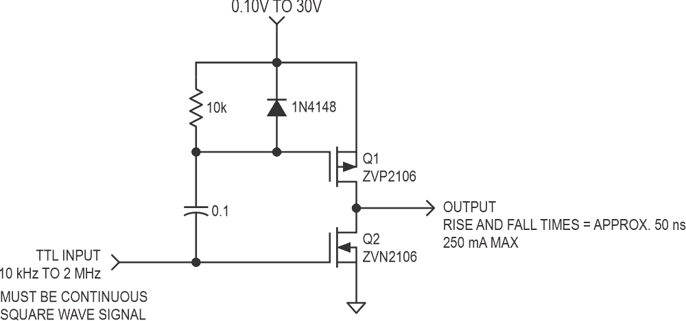

N-ch and P-ch transistors form push-pull driver
Diodes ZVN2106A ZVP2106A
This circuit can produce high speed output signals with fast rise and fall times. The unique charge pump action allows the voltage of the upper P-ch device to range from millivolts to hundreds of volts. The output current is only limited by the rating of the transistors. I have used this circuit beyond 2 MHz.
