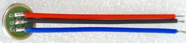

Primo EM273

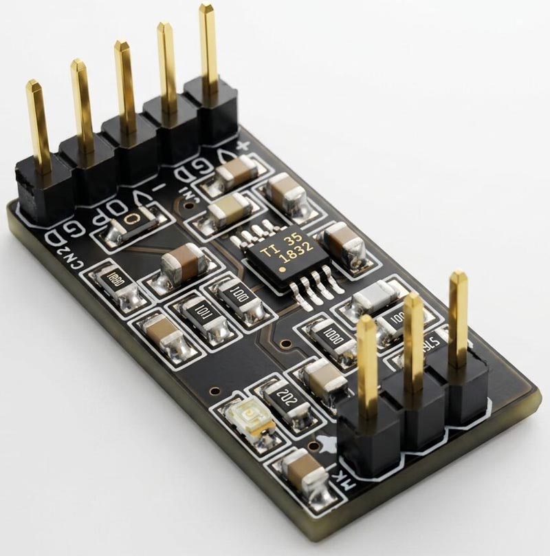

This 3-wire microphone pre-amplifier in Figure 1 is designed using the low-power, low-noise, and low-distortion OPA1692 audio operational amplifier, making it ideal for high-performance electret microphone applications. The circuit is optimized for electret microphones that use a 3-wire interface, providing excellent audio quality while maintaining minimal power consumption.
3-wire electret microphone pre-amplifier.
Figure 1. 3-wire electret microphone pre-amplifier.

Features
  • Power Supply ±5 V DC
  • Current consumption less than 1.5 mA (without LED)
  • Maximum sound level pressure (SPL) 120 dB
  • On board power LED
  • Bandwidth 20 Hz to 20 kHz
  • Gain 11.79 V/V or 21.43 dB
  • PCB dimensions: 25.88 × 13.34 mm

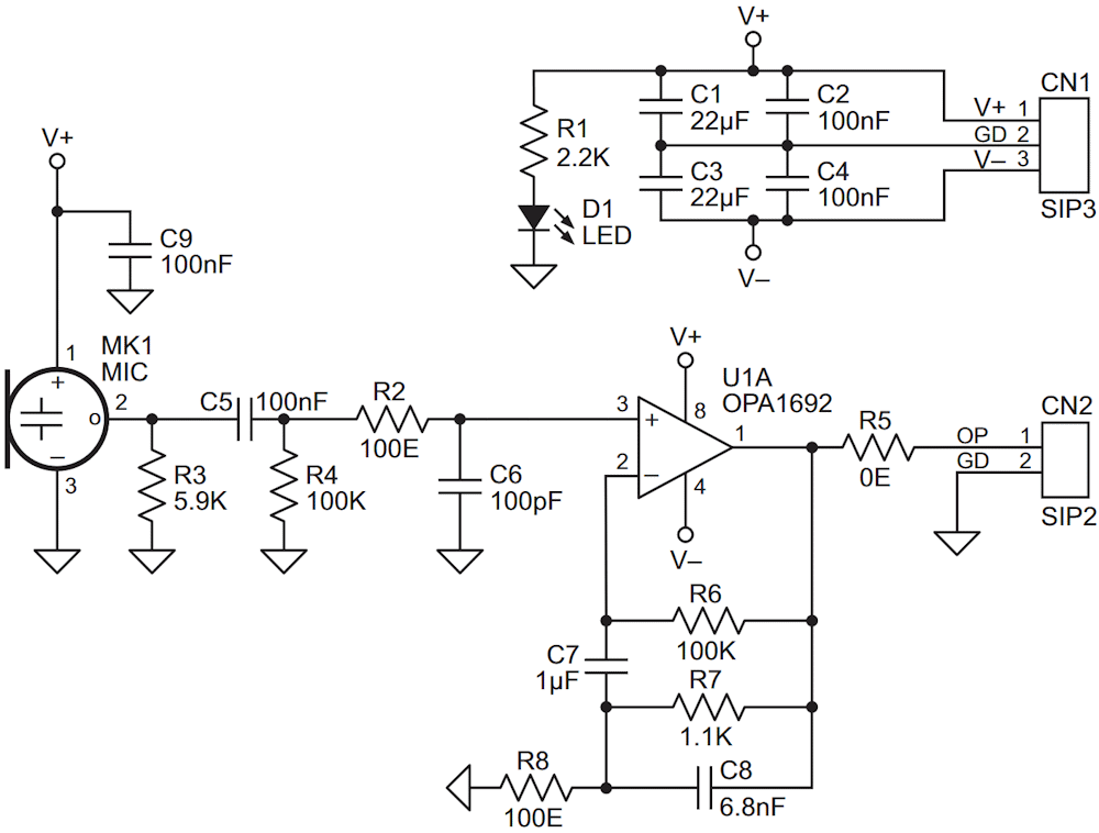

Schematic
Schematic diagram of the pre-amplifier.
Figure 3. Schematic diagram of the pre-amplifier.
Figure 3 shows the schematic diagram of the electret microphone pre-amplifier. Table 1 shows the bill of materials.
Table 1. List of circuit components
Designator Description Package/
Footprint
CN1 3 pin male header Pitch 2.54 mm
CN2 2 pin male header Pitch 2.54 mm
C1, C3 22 µF/16 V ceramic 0805
C2, C4, C5, C9 100 nF/50 V ceramic 0805
C6 100 pF/50 V ceramic 0805
C7 1 µF/25 V ceramic 0805
C8 6.8 nF/50 V ceramic 0805
D1 Red LED 0805
MK1 Mic EM273
R1 2.2 kΩ 5% 0805
R2, R8 100 Ω 5% 0805
R3 5.9 kΩ 1% 0805
R4, R6 100 kΩ 5% 0805
R5 0 Ω 0805
R7 1.1 kΩ 1% 0805
U1 OPA1692 VSOP8

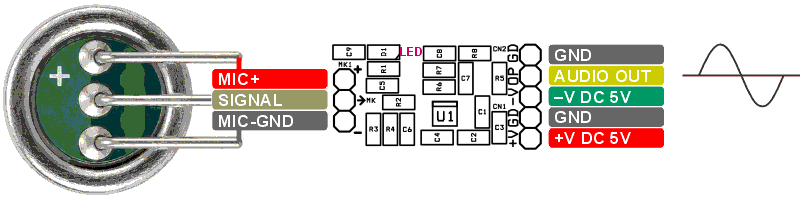

Figure 4 shows the pre-amplifier connection diagram.
The pre-amplifier connection diagram.
Figure 4. The pre-amplifier connection diagram.
