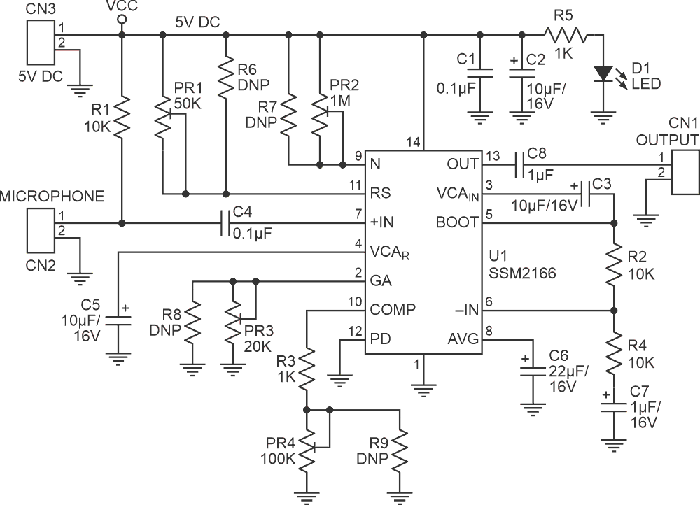

The circuit shown in Figure 1 is a complete microphone signal conditioning system based on a single SSM2166 integrated circuit.
Hi-end microphone preamplifier with variable compression, noise gating and adjustable gain
Designed primarily for voiceband applications, this integrated circuit provides amplification, RMS detection, limiting, variable compression, and downward expansion. An integral voltage-controlled amplifier (VCA) provides up to 60 dB of gain in the signal path with approximately 30 kHz bandwidth. Additional gain is provided by an input buffer OPAMP circuit that can be set anywhere from 0 dB to 20 dB, for a total signal path gain of up to 80 dB. The project operates on a single +5 V supply, accepts input signals up to 1 V RMS, and produces output signal levels > 1 VRMS (3 VP-P) into loads > 5 kΩ. The internal RMS detector has a time constant set by an external capacitor. The SSM2166 contains an input buffer and automatic gain control (AGC) circuit for audio and voiceband signals. Circuit operation is optimized by providing a user-adjustable time constant and compression ratio. A downward expansion (noise gating) feature eliminates circuit noise in the absence of an input signal. Onboard trimmer potentiometer allows the user to set the downward expansion threshold, the limiting threshold (rotation point), input buffer fixed gain, and the internal VCA’s nominal gain at the rotation point.
Schematic diagram of a microphone preamplifier.
Figure 1. Schematic diagram of a microphone preamplifier.

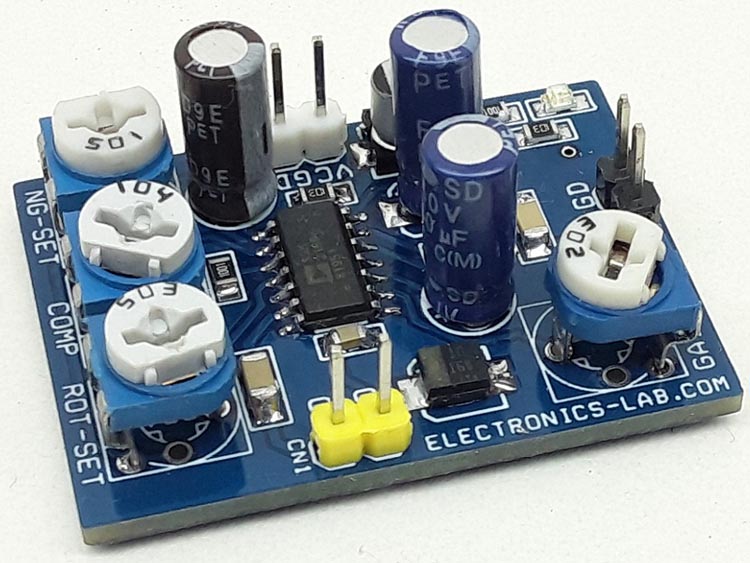

Features
  • Operating supply 5 V DC (4.5 V to 5.5V)
  • Supports condenser microphone
  • Adjustable compressions ration using trimmer potentiometer
  • Adjustable rotation point using trimmer potentiometer
  • Adjustable noise gate threshold using trimmer potentiometer
  • Header connector for microphone
  • Header connector for output
  • Header connector for supply input
  • Low noise and distortion
  • Power-down feature
  • 20 kHz bandwidth (61 dB)
  • Power LED D1
  • PCB dimensions 36.99 × 26.51 mm
Compression ratio (can be set using optional fixed resistor R9 or trimmer potentiometer PR4)
The compression ratio may be varied from 1:1 (no compression) to over 15:1 via a trimmer potentiometer PR4 or optional resistor R9, RCOMP. Input signals above VRP are compressed with a fixed compression ratio of approximately 15:1. The compression ratio can be set by adjustable trimmer Pot PR4 connected between the COMP RATIO pin (Pin 10) and GND or optional R9. Lowering RCOMP gives smaller compression ratios with values of about 17 kΩ or less resulting in a compression ratio of 1:1. AGC performance is achieved with compression ratios between 2:1 and 15:1, and is dependent on the application. A 100 kΩ potentiometer PR4 used to allow this parameter to be adjusted.
This region of operation is the “limiting region.” Varying the compression ratio has no effect on the limiting region. The breakpoint between the compression region and the limiting region is referred to as the “limiting threshold” or the “rotation point,” and is user-specified in the SSM2166. The term “rotation point” derives from the observation that the straight line in the compression region “rotates” about this point on the input/output characteristic as the compression ratio is change.
Gain adjust – trimmer potentiometer PR3 or optional resistor R3
The maximum gain of the project is set by the GAIN ADJUST Trimmer pot PR3. This resistor, with a range between 1 kΩ and 20 kΩ, will cause the nominal VCA gain to vary from 0 dB to approximately 20 dB, respectively. To set the VCA gain to its maximum can also be achieved by leaving the GAIN ADJUST pin in an OPEN condition (no connect).
The gain of the system with an input signal level of VRP is fixed by RGAIN regardless of the compression ratio, and is the “nominal gain” of the system. The nominal gain of the system may be increased by the user via the onboard VCA by up to 20 dB. Additionally, the input buffer of the SSM2166 is configured to provide fixed gains of 0 dB to 20 dB with R2 and R4. The gain of the VCA at the rotation point is set by the value of an optional resistor R8 or trimmer potentiometer PR3 connected between Pin 2 and GND, RGAIN.
Rotation point adjustment – trimmer potentiometer PR1 or optional resistor R6
An internal dc reference voltage in the control circuitry, used to set the rotation point. By varying a trimmer potentiometer PR1 or optional resistor R6, connected between the positive supply and the ROTATION POINT SET pin (Pin 11), the rotation point may be varied from approximately 20 mV rms to 1 V rms. For example, a 1 kΩ resistor would typically set the rotation point at 1 V rms, whereas a 55 kΩ resistor would typically set the rotation point at approximately 30 mV rms. Since limiting occurs for signals larger than the rotation point (VIN > VRP), the rotation point effectively sets the maximum output signal level. It is recommended that the rotation point be set at the upper extreme of the range of typical input signals so that the compression region will cover the entire desired input signal range. Occasional larger signal transients will then be attenuated by the action of the limiter.
Noise gate adjust – trimmer potentiometer PR2 or optional resistor R7
The range of the noise gate is from 0.3 mV to over 20 mV relative to the output of the buffer. To fit this range to your application, you may have to attenuate the input or apportion the buffer gain and VCA gain differently.

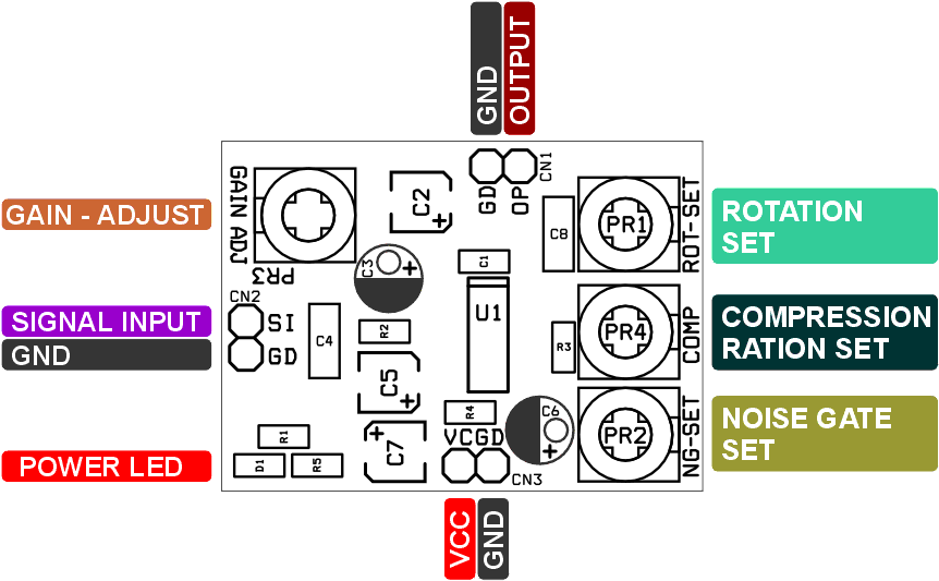

Figure 2 shows the amplifier connection diagram.
The amplifier connection diagram.
Figure 2. The amplifier connection diagram.

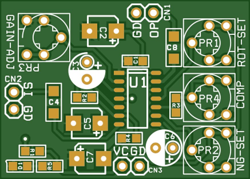

The Gerber project files can be downloaded from the link in the Downloads section. The PCB layout is shown in Figure 3. Table 1 shows the bill of materials.
The PCB layout.
Figure 3. The PCB layout.
