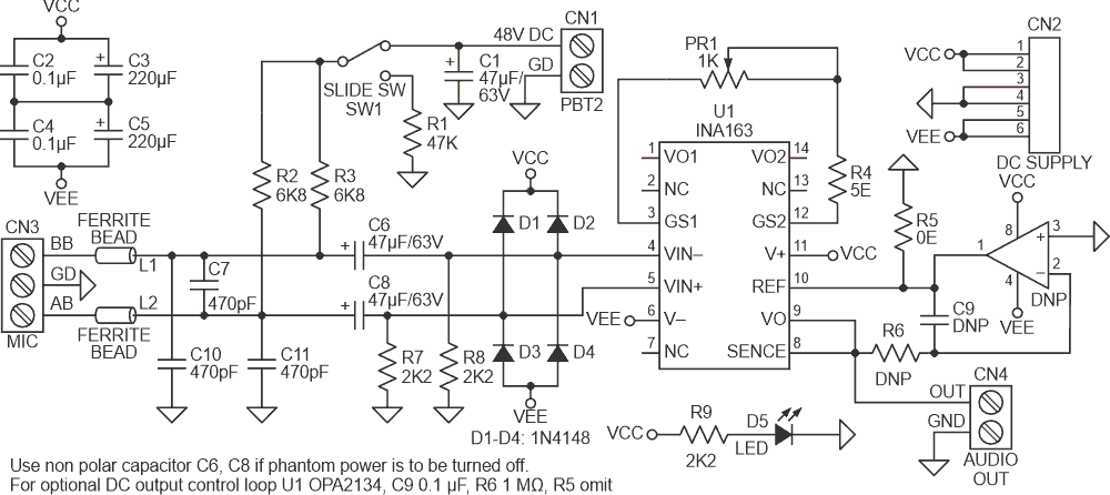

The project presented here is a professional quality phantom powered microphone pre-amplifier (Figure 1). The project is built using the INA163 chip from TI. The Chip is a very low-noise, low-distortion, monolithic instrumentation amplifier. R2 and R3 provide a current path for a conventional 48 V phantom power source for a remotely located microphone. A slide switch SW1 allows phantom power to be disabled. C6 and C8 block the phantom power voltage from the INA163 input circuitry. Additional input protection against ESD and hot-plugging, four 1N4148 diodes D1, D2, D3, D4 connected from the input to supply lines. R7 and R8 provide a path for the input bias current of the INA163. Gain is set with a variable resistor, PR1, in series with R4. R4 determines the maximum gain. The total resistance, R4 + PR1, determines the lowest gain. A special reverse-log taper potentiometer for PR1 can be used to create a linear change (in dB) with rotation. LED D5 is used as a power indicator. L1, L2, C7, C10, and C11 components protect the inputs from EMI and RFI noise.
Schematic diagram of a phantom powered microphone preamplifier.
Figure 1. Schematic diagram of a phantom powered microphone preamplifier.
Optional DC output control loop
Input offset current (typically 100 nA) creates a DC differential input voltage that will produce an output offset voltage. This is generally the dominant source of the output offset voltage. With a maximum gain of 1000 (60 dB), the output offset voltage can be several volts. This may be entirely acceptable if the output is AC-coupled into the subsequent stage. An optional circuit is provided to tackle this problem. An inexpensive FET-input op-amp U2A in a feedback loop drives the DC output voltage to 0 V. Op-amp is not in the audio signal path and does not affect signal quality.
To add an additional DC output control loop you need to do the following:
  • U2A = OPA2134 SOIC8
  • C9 = ceramic capacitor 0.1 µF/50 V SMD size 0805
  • R6 1 MΩ 5% SMD resistor size 0805
  • Omit resistor R5
Connections and other details
  • CN1: pin 1 = +48 V DC phantom power Input, Pin 2 = GND
  • CN2: pin 1-2 = VCC +15 V DC, Pin 3-4 = GND, Pin 5-6 VEE –15 V DC
  • CN3: pin 1 = BB microphone – VIN, Pin 2 = GND, Pin 3 = AB microphone + VIN
  • CN4: pin 1 = audio output, Pin 2 = GND
  • D5: power LED
  • SW1: phantom power enable/disable switch
Note: Non-polarized capacitors should be used for C6 and C8 if phantom power is to be disabled.

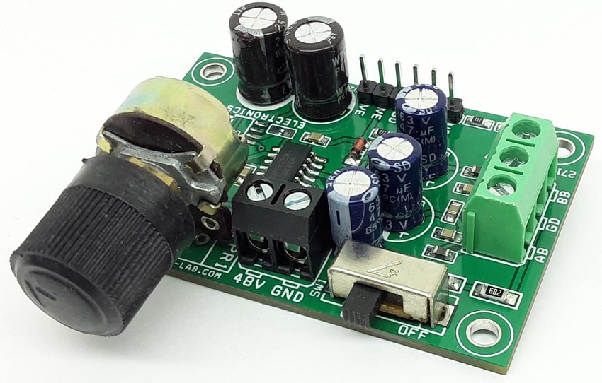

Features
  • Power supply dual 15 V DC (±15 V DC)
  • On board power LED
  • Slide switch for phantom power enable/disable
  • 3 pin screw terminal for microphone connections
  • 2 pin screw terminal for audio output
  • 2 pin screw terminal for phantom power input 48 V DC
  • 6 pin male header for power input
  • Gain up to 1000 V/V (60 dB)
  • Potentiometer PR1 gain adjust
  • PCB dimensions 60.17 × 39.85 mm
  • 4 × 3 mm mounting holes

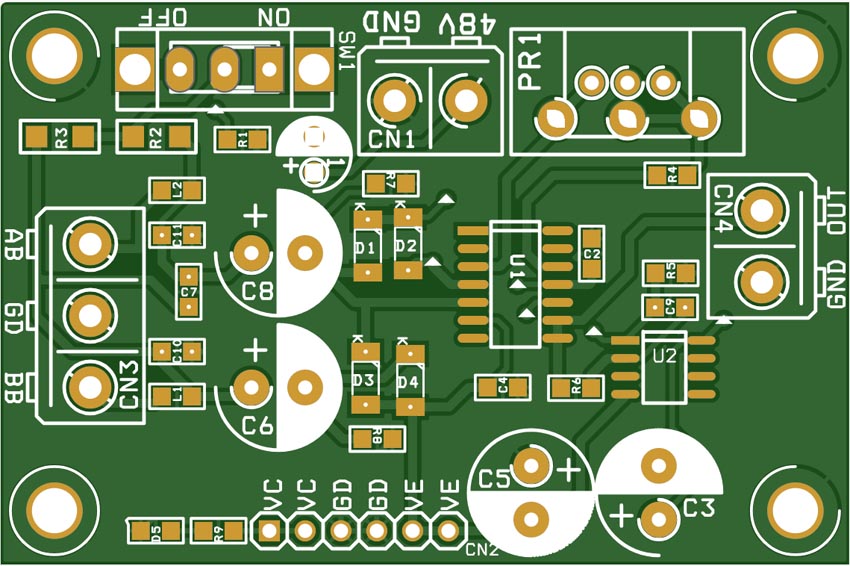

The Gerber project files can be downloaded from the link in the Downloads section. The PCB layout is shown in Figure 3.
The PCB layout.
Figure 3. The PCB layout.
