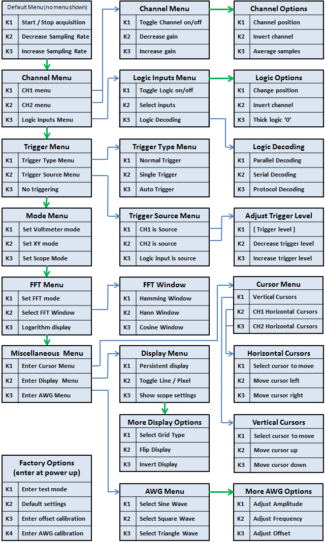

Factory Setup
The device can enter a few factory options if a key is pressed during power up:
  • K1) The device will enter a test mode. The following data will be shown on the screen: data acquired from the channels, the AWG buffer, the buttons pressed.
  • K2) The device will restore the default factory settings and erase calibration data.
  • K3) The device will enter the offset calibration function.
  • K4) The device will enter the AWG calibration function
User Interface
The K4 button is the MENU button, used to navigate thru all the menus.
The K1 - K3 buttons action depend on the current menu.
Below is the navigation tree. The green arrows represent the flow when pressing the MENU button. If a menu doesn't show a green arrow, the next menu will be the default.
Xprotolab Menu
Click to enlarge
