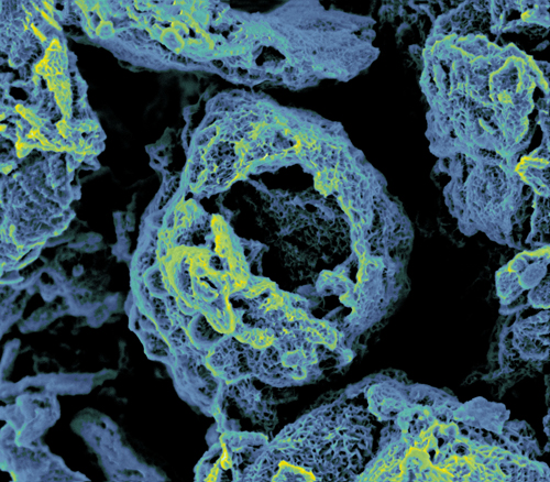

Resembling broken eggshells, graphene structures built around bubbles produced a lithium-air battery with the highest energy capacity to date, according to scientists at Pacific Northwest National Laboratory and Princeton University. This black, porous material could replace the traditional smooth graphene sheets in lithium-air batteries, which become clogged with tiny particles during use. As an added bonus, the team’s new material does not rely on platinum or other precious metals, reducing its potential cost and environmental impact.

The team began by combining a binding agent with graphene, a special form of carbon. The binding agent dispersed the graphene in solution, like soap disperses grease in dishwater. The graphene and binder were then added to water and mixed using a process that created bubbles inside the solution. The graphene and binder formed and hardened around the bubbles. When the bubbles eventually popped, hollow spheres of graphene were left behind. The tiny black particles are only 3 to 4 microns in diameter, ten times smaller than a human hair.
Using both modeling and microscopy, the scientists analyzed the graphene structures and their performance. They performed density functional theory calculations on the supercomputing system at the National Energy Research Scientific Computing Center. They studied the particles using electron microscopy at the Environmental Molecular Sciences Laboratory.
The researchers found that the black porous structures store more than 15,000 milliamp hours per gram of graphene, making it far denser in term of energy capacity than other materials.
