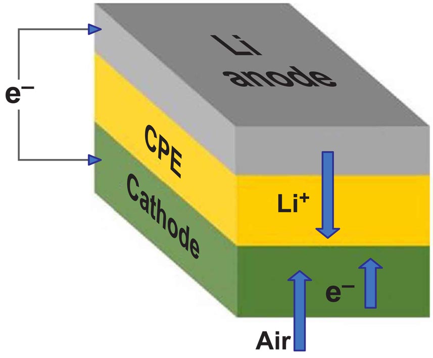

Lithium-air battery cell
Schematic shows lithium-air battery cell consisting of lithium metal anode,
air-based cathode, and solid ceramic polymer electrolyte (CPE). On discharge
and charge, lithium ions (Li+) go from anode to cathode, then back.
The new battery uses lithium-air chemistry, but is different to other lithium-air battery designs in that it uses a solid electrolyte. The research team claims that the new battery chemistry has the potential to boost the energy density to four times more than current Li-ion designs. The solid electrolyte also brings another advantage in that it makes the battery much safer, by not being a fire hazard by spontaneously combusting. Liquid electrolytes also tend to be hazardous, and a solid electrolyte can’t leak.
In today’s lithium-air battery designs, the lithium in the lithium metal anode moves through a liquid electrolyte to combine with oxygen during the discharge, yielding lithium peroxide (Li2O2) or superoxide (LiO2) at the cathode. The lithium peroxide or superoxide is then broken back down into its lithium and oxygen components during charging. This allows the battery to store and release energy as it is needed. The newly developed solid electrolyte is composed of a ceramic polymer material made from relatively inexpensive elements in nanoparticle form. This new solid electrolyte enables chemical reactions that produce lithium oxide (Li2O) on discharge.
