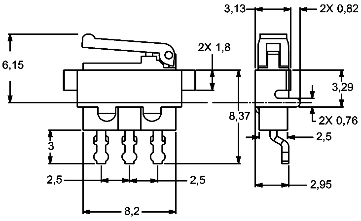

The microminiature MDS Series switches are RoHS-compliant and feature a 100m ohms contact resistance. The snap-acting tactile feel switch offers a total travel of 2.9mm and a contact rating of 300mA @ 30VDC. The MDS Series’ mounting bracket ensures a robust right-angle engagement with handle mechanisms or enclosures. C&K offers designers the ability to have an SMT surface plate with or without alignment posts, and versions opening to the right or left.
MDS microminiature switch dimensions |
