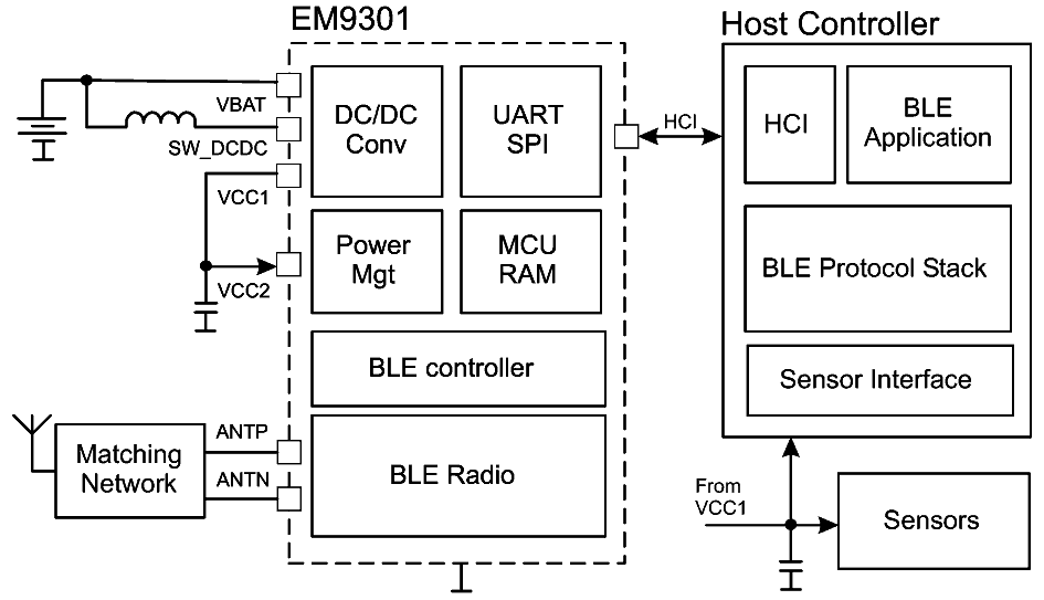

EM Microelectronic announces its Bluetooth smart-qualified controller, the EM9301. Optimized for ultra-low power wireless sensing, remote control and monitoring applications, the EM9301 operates on as little as 0.8V. It can be powered by a wide range of common single-cell batteries or energy harvesters such as solar cells, piezo-electric and electro-magnetic elements. The EM9301 is fully Bluetooth smart qualified for single-mode master and slave applications and combines the Physical layer, Link layer and Host Controller Interface (HCI) layer in one flexible chip.
EM Microelectronic - EM9301
In receive mode, the requires only 16.5mA, while competing products consume up to 23mA. An integrated DC/DC converter powers the EM9301 RF circuitry while concurrently delivering up to 100mA to an external device (e.g. sensors, external microcontroller, LED indicators, or displays & driver circuits). RF output power is programmable from +4dBm to -20dBm in 6 steps. The system power budget can be further optimized by putting the EM9301 in SLEEP or IDLE mode, where it consumes less than 1µA. The overall bill of material and size can be reduced significantly by the proper design of a 200-ohm differential impedance PCB trace antenna, eliminating the need for matching, balun, and antenna components.
The EM9301, when paired with a low-power host controller, comprises a cost/performance/size optimized solution for most Bluetooth smart applications such as wireless health and fitness monitoring, electronic leashes, and smartphone-based sensing and controls.
Typical Application Schematic
EM9301 Typical Application Schematic
