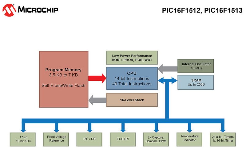

PIC16F1512/13 devices Block Diagram
Click to enlarge
Compared to other members of the PIC16F151X family, these two new devices deliver increased analog capability, including a 10-bit Analog-to-Digital Converter (ADC) with hardware Capacitive Voltage Divider (CVD) support for mTouch™ capacitive touch sensing implementation. The additional control logic enables automated touch sampling, which reduces software size and lowers CPU usage. It also provides an automatic control of guard-ring drive and a programmable sample-and-hold capacitance to better match larger touch or proximity sensors.
