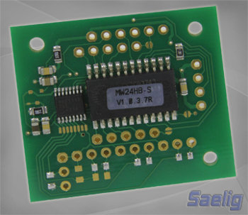

Saelig Company Inc. has introduced new Warrior Modules containing the complete electronics required for joystick, mouse or I/O functionality via USB. Based on the successful Warrior USB-interface ICs, these new boards accept analog inputs in the range of 0V to 5V, are compatible with most joystick sensors, and also facilitate measurement, sensor, and other I/O applications.
Sealig - Warrior Modules
Warrior ICs from Code Mercenaries are a family of universal I/O controllers for USB that handle all USB’s complex protocol details without needing Windows drivers since Warrior ICs appear to the OS as HID Device Class (Human Interface Device). This means that standard system drivers allow access to Warrior ICs directly from application programs. (A Linux driver is also available.)
JoyWarrior24A8L-MOD has four analog axes with 8-bit resolution, while JoyWarrior24A10L-MOD has three analog axes with 10 bit resolution. Both modules allow either eight direct connected buttons or sixteen buttons in a 4 × 4 matrix. Four auxiliary outputs can be used to drive LEDs or for other uses. These modules are based on the JoyWarrior24F8 IC, a low cost three axis acceleration sensor.
MouseWarrior24H8-MOD is a Mouse/Joystick hybrid which can be switched between mouse and joystick modes at any time. It supports three analog axes with 8 bits each and up to six buttons. Auto-centering and drift compensation for the mouse function can optionally be disabled. The MouseWarrior24F8 IC on which this module is based is a mouse replacement chip that does not need an operating surface.
IO-Warrior56-MOD offers fifty general purpose I/O pins, with a typical maximum input or output rate of 1000Hz in a Full-Speed USB2.0-compliant interface (12Mbit/sec). Based on the IO-Warrior56-LFXI IC, IO-Warrior56-MOD gives simple access to I/O lines via USB since, like other Warrior modules, it has been designed as a generic HID device.
