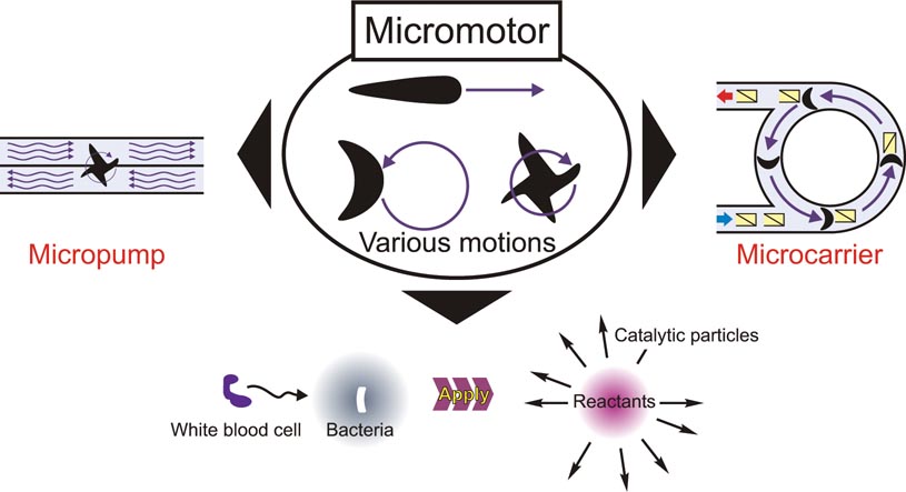

This image shows a possible application of chemical micromotors. Credit: Daigo Yamamoto/Doshisha
Researchers from Doshisha University in Kyoto, Japan have now discovered, however, that two-sided materials aren't necessary to make micromotors move. The researchers placed tiny spheres made only of platinum in hydrogen peroxide and observed the particles' movement through a microscope. Although the individual spheres bounced about randomly, the researchers noticed that clumps of particles began to exhibit regular motions. The clumps shaped like teardrops moved forward, those that resembled windmills started to spin, and the boomerang shaped clumps traveled in a circle. After creating a theoretical model of the forces at work, the researchers realized they could explain the regular motions by the asymmetrical drag generated by the different shapes.
The researchers envision combining their new type of motors with existing motors to create easily controllable machines with a versatile range of motions.
