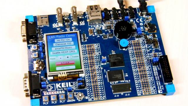

Internet Radio Audio Streaming Solution
Designers can implement some or all of the functionality needed to stream music from SHOUTcast online radio stations and give users control of music selection and playback through a UI displayed on an integrated LCD panel. Based on the dual-core LPC4357, the Internet Radio Audio Streaming solution demonstrates partitioning of application software between two cores. Time-sensitive audio decoding and processing is handled by the ARM® Cortex-M4F, while the TCP/IP stack, user interface and application processing are handled by the Cortex-M0 processor. The solution comprises a Keil MCB4357 evaluation board as well as free downloadable software for the Internet Radio application, a SHOUTcast radio implementation, emWin graphics library, and FreeRTOS with an LwIP TCP/IP stack. MP3 decoder software is available with an additional license.
