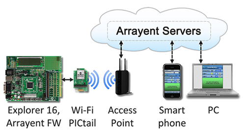

“Arrayent’s Tool Kit for Embedded Wi-Fi enables Microchip Technology Inc.’s customers to quickly connect their embedded product to web applications and smartphones, breaking free of the LAN to get on the full Internet” said Shane Dyer, President of Arrayent, Inc. “Our Internet-Connect Tool Kit, makes it simple to communicate with an embedded Wi-Fi product over the internet from anywhere in the world. Arrayent’s Tool Kit eliminates installation constraints most LAN-based products impose on users. By placing the product’s web application server in the cloud instead of on the embedded product, this eliminates the requirement for a fixed IP address or end-users having to re-program their router to open up communication ports.
Arrayent’s Internet-Connect Service delivers three points of value to embedded Wi-Fi systems. First, Arrayent simplifies product installation because its automatic consumer NAT firewall tunneling technology eliminates the need for end customers to pay extra for fixed IP address or waste time opening firewall ports. Second, Arrayent servers, hosted in the Internet cloud off, loads local communication computing processing tasks, which results in lower product hardware cost. Third, since more and more product value occurs in the web applications hosted in the Internet cloud, product applications can be easily upgraded on the cloud-based servers, eliminating complex firmware upgrades in the field.

Arrayent Internet-Connect Tool Kit enables embedded designers to wirelessly connect a Microchip Explorer 16 Development Board application, with the AC164136-4 PICtail / PICtail Plus module, to an Internet hosted application viewable on a smart phone or PC browser.
The Arrayent Internet-Connect Tool Kit for Embedded Wi-Fi Design has four components:
  • Internet Connect Code Library and PIC microcontroller sample code to quickly connect a PIC microcontroller-based Wi-Fi application to the Internet.
  • Internet Connect Server Account to provide access to Arrayent’s Internet-Connect servers, APIs, and tools.
  • The Configurator, which is a web application, to define specific product attributes.
  • The Utility Application, which is a web-based application, to verify and demonstrates the Internet connectivity of a device.
Once connected, the design engineer can remotely monitor and control their Explorer 16 board (not included) via a PC or smart phone browser, using the Utility Application or web application.
