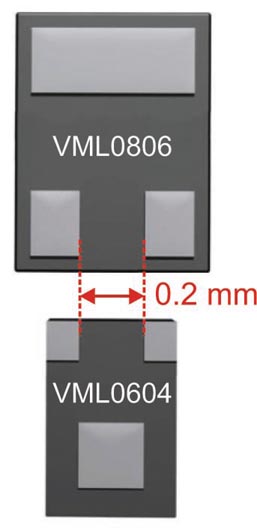

2. Precise 0.2 mm terminal spacing improves mountability
As devices become smaller substrate mounting becomes increasingly difficult. In response ROHM has maintained a 0.2 mm terminal gap that facilitates mounting using existing equipment.
