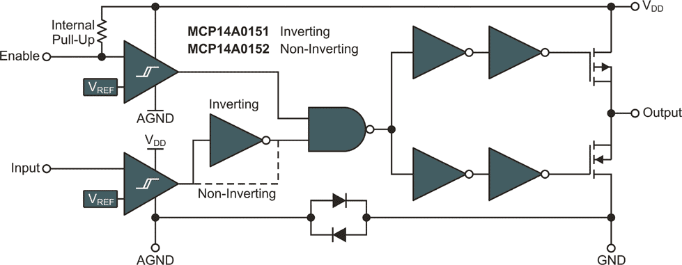

The MCP14A005X and MCP14A015X MOSFET drivers low input threshold is compatible with various Microchip PIC® microcontrollers (MCUs) and dsPIC® Digital Signal Controllers (DSCs), even when operating at lower voltages. This enables customers to design applications with MCUs operating as low as 2.0 V, using the MOSFET driver to boost the output signals to 18 V, reducing power loss in the controller and minimizing conduction loss in the power MOSFET. The threshold levels balance the need for noise immunity with the ability to function with a wider variety of controller products, including Microchip’s devices. These drivers are designed for use in power supply, lighting, automotive and consumer electronics markets, including embedded power conversion, brushed DC motor, unipolar stepper motor and solenoid/relay/valve control applications, among others.
| Functional Block Diagram. |
