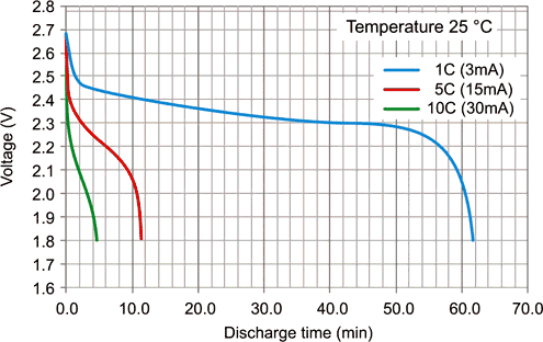

Murata - UMAC040130A003TA01
Constant current discharge characteristic.

  1. High-rate charge/discharge:
    Max. charge/discharge rate (current): 10C (30 mA)

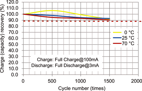

  3. Extended cycle life:
    Charge (capacity) recovery rate of 90% or higher after 1,000 cycles
Charge-discharge cycle characteristic.
