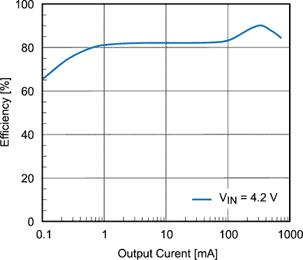

Efficiency vs Output Current
Efficiency vs Output Current.

  • High efficiency (90%: 4.2 V⇒3.3 V, at 300 mA)
