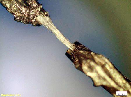

An optical image of the microtube bundle placed between two electrodes
electrodes. (Credit: Kholkin et al., Applied Physics Letters).

The team of investigators dried a standard peptide solution for a day at room temperature to allow diphenylalanine to assemble into microtube structures, with individual tubes up to 1 millimeter long and 1-3 micrometer wide in diameter. To increase the current produced by the structures, the group created bundles of several microtubes and placed them between needle electrodes to measure the structures’ properties.
