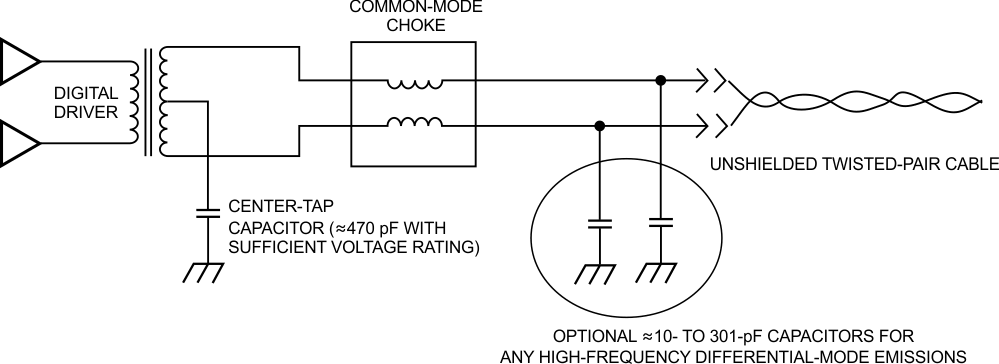

If the coupling transformer has a center tap on the winding to which the cable attaches, you can use this tap to reduce the level of these nasty common-mode currents on the cable. Connecting the tap to a quiet earth ground provides a path to shunt these currents harmlessly to earth before they can sneak out the cable and radiate (Figure 1). A capacitor in the connection provides the same RF grounding function but presents a high impedance to any 60-Hz ground loop currents if the far end of the cable also connects to a ground-referenced transformer winding. This capacitor should be only a few hundred picofarads, must have short leads and circuit traces between transformer tap and good earth ground, and must have a sufficiently high voltage rating to withstand high-voltage transients as the end market requires.

Using a common-mode choke in addition to the center-tap trap results in a real common-mode killer. The two techniques complement each other, and it can be helpful to use both together in stubborn cases. As Figure 1 indicates, you can place the common-mode choke virtually a transformer on its side in line with the cable, preferably at a point just before the cable exits the (ideally) shielded enclosure to avoid stray-noise pickup on the cable after the choke. A similar but opposite magnetic magic takes place in the common-mode choke, which must present a high series impedance instead of a low shunt impedance to common-mode currents. The winding turns ratio is 1-to-1, and the polarity is such that the magnetic fields from the differential signal now cancel, resulting in almost zero attenuation other than that resulting from the leakage inductance. On the other hand, the common-mode currents cause magnetic addition, which results in high impedance and reduces the level of unwanted currents.

Two capacitors following the common-mode choke can reduce high-frequency differential-mode emissions caused by non-common-mode currents.
