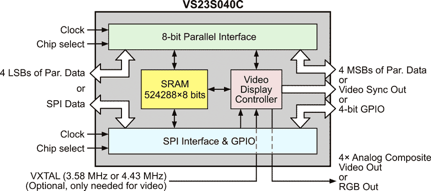

The VS23S040 block-diagram
The VS23S040 block-diagram.
