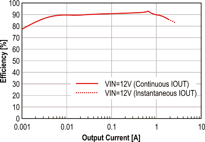

Typical Performance Characteristics
Typical Performance Characteristics.

  • 90% efficiency (IOUT = 1000 mA)
