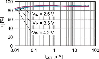

The S-85M0A Series of ultra-high efficiency step-down switching regulators is housed in the WLP-6L, the industry’s most compact package (1.25 × 0.79 × t0.55 mm), and achieves an ultra-low current consumption of 260 nA, the industry’s top-class current consumption. It reduces the footprint of the mounting area and the surrounding components by 52% compared to our previous product.
Efficiency vs Output Current
Efficiency vs Output Current.
