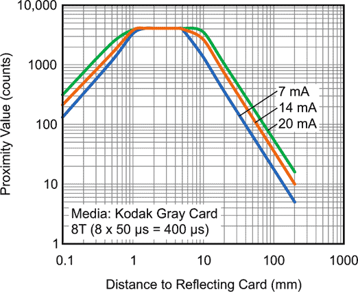

Proximity Value vs. Distance
Proximity Value vs. Distance.
Compared to previous generation devices, the VCNL36687S requires less energy to carry out the same functionality; with a 20 mA pulse current, the VCNL36687S can detect a Kodak Gray Card at a distance of 20 cm, where previous VCNL series devices required 200 mA of current.
