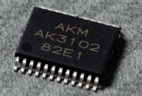

AKM has developed ultra-low noise coreless current sensors for improving audio quality of large sized speakers such as subwoofers. The AK310x series is suitable for a system which controls voicecoil motion in speakers (Motional Feedback) by current feedback. This series can be used for controlling industrial motors, since it is certified to UL safety standards.
AKM - AK3101, AK3102, AK3103, AK310H
Features
  • Achieving Ultra-Low Noise:
    Although conventional current sensors had large noise, the AK310x series reduces the noise extremely to combine with a signal processing IC and an ultra-high sensitivity Hall element. It achieves the world’s best noise performance of –108 dBm/√Hz.
  • Ultra-Low Impedance:
    The damping factor of the speaker is almost unaffected because the AK310x series can measure the current with a 1.6 mΩ impedance. This series is suitable for motional feedback system.
  • Ultra-small Package Certified to Safety Standard:
    The AK310x series adopts an ultra-small coreless package, (D/W/H: 7.6 × 7.9 × 1.15 mm). It is certified to IEC/UL60950 and planned to be certified to IEC/UL1577, suitable for various industrial applications such as AC motors and general-purpose inverters.
AKM - AK3102
Main Specifications of the AK310x series
Product Name Linear Sensing Range
(A)
Sensitivity
(mV/A)
Output Noise
(dBm/√Hz)
Response Time
(μs)
AK3101 ±10.7 195 –102 2
AK3102 ±21 100 –108 2
AK3103 ±35 60 –108 2
AK310H ±42 50 –108 2
