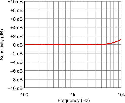

CMM-2718AT-42308-TR Frequency Response Curve
CMM-2718AT-42308-TR Frequency Response Curve.
