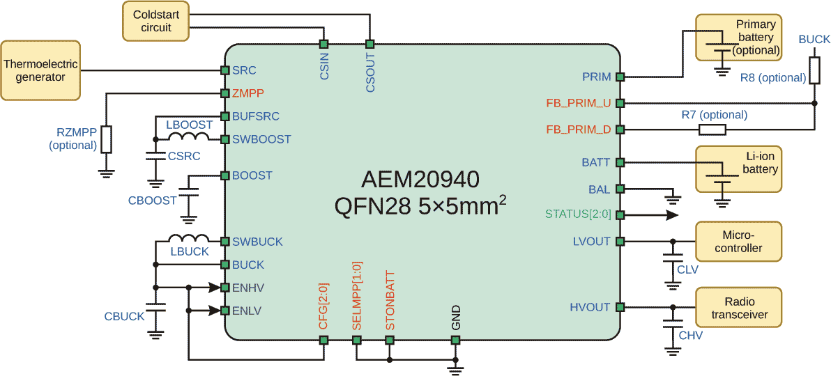

Supplied in a space-saving 28-pin QFN package, the AEM20940 is a highly advanced device based on proprietary technology that is capable of extracting available input current up to levels of 110 mA. Taking DC power from a connected thermal electric generator (TEG), it can supervise the storing of energy in a rechargeable element and simultaneously supply energy to the system via 2 different regulated voltages. This is done through its built-in low noise, high stability 1.2/1.8 V and 2.5/3.3 V LDO voltage regulators. The lower voltage can be employed for driving the system microcontroller, while the higher voltage is intended for the RF transceiver.
AEM20940 Typical Application Circuit
AEM20940 Typical Application Circuit.
