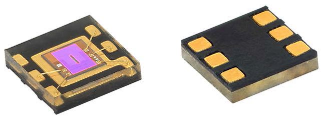

Space-Saving Device Features Patented Optical Level Filter Technology in Compact 2 mm by 2 mm by 0.4 mm Package
Vishay VEML6035
The Optoelectronics group of Vishay Intertechnology introduced a new ambient light sensor for small form factor applications such as smart watches and sport bands where very high sensitivity is needed to allow light to be sensed through an often very dark cover glass. The Vishay Semiconductors VEML6035 features a highly sensitive photo-diode, low-noise amplifier, and 16-bit ADC in a miniature low profile, transparent surface-mount package measuring only 2 mm by 2 mm by 0.4 mm. The sensor uses an active interrupt function that is triggered outside the threshold window settings to eliminate loading on the host.

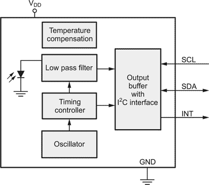

Circuit Block Diagram
Circuit Block Diagram.
Vishay’s patented Filtron™ wafer-level optical filter technology enables ambient light spectral sensitivity close to that of the human eye. The device offers detection with highly linear behavior from 0.004 lx to 6710 lx and resolution down to 0.0004 lx/ct, allowing for operation in applications with low-transmittance (dark) lens designs. The VEML6035 provides 100 Hz and 120 Hz flicker noise rejection and excellent temperature compensation to maintain stability despite changes in ambient temperature. The device features low power consumption down to just 170 μA in operating mode and 0.5 μA in programmable shutdown mode.
