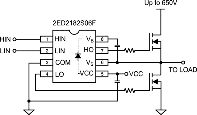

The 2ED2182S06F Typical Application Block Diagram
The 2ED2182S06F Typical Application Block Diagram.
