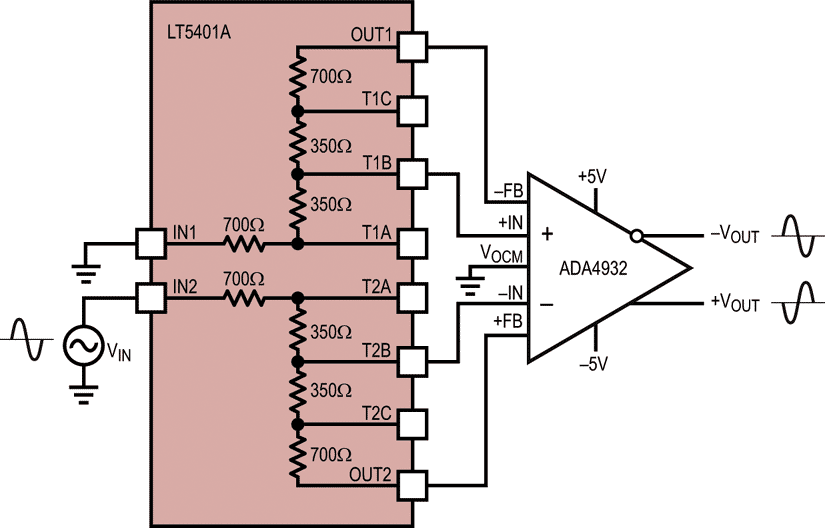

Using LT5401 with a Fully Differential Amplifier for Single-Ended to Differential Conversion, G = 1
Using LT5401 with a Fully Differential Amplifier for Single-Ended to Differential Conversion, G = 1.

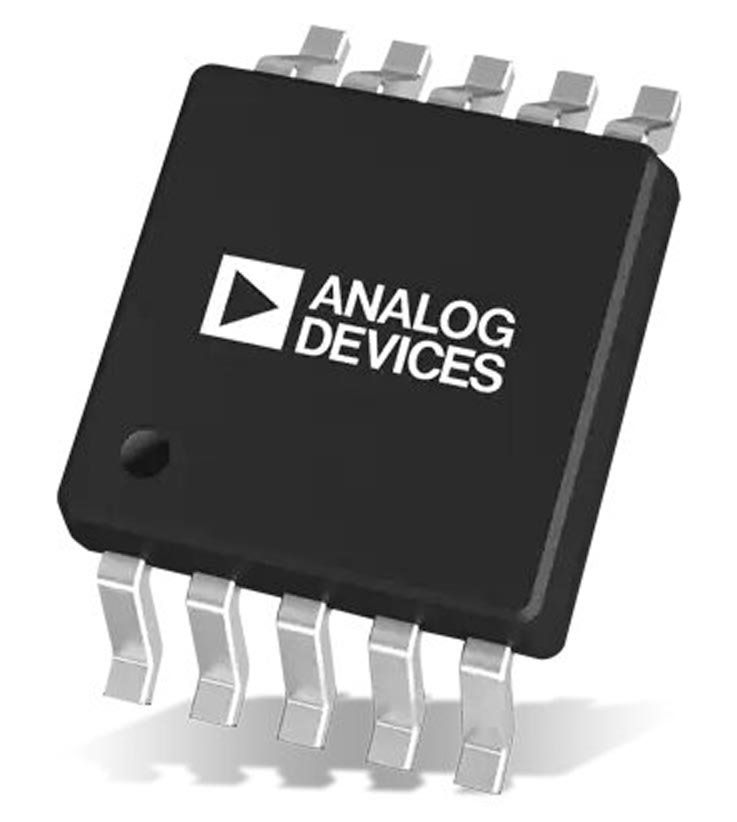

The LT5401 is available in a compact 10-lead MSOP package with exposed paddle for improved thermal performance over a temperature range of –55 °C to 150 °C.

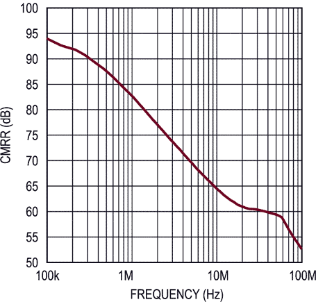

Input Common Mode Rejection Ratio vs Frequency
Input Common Mode Rejection Ratio vs Frequency.

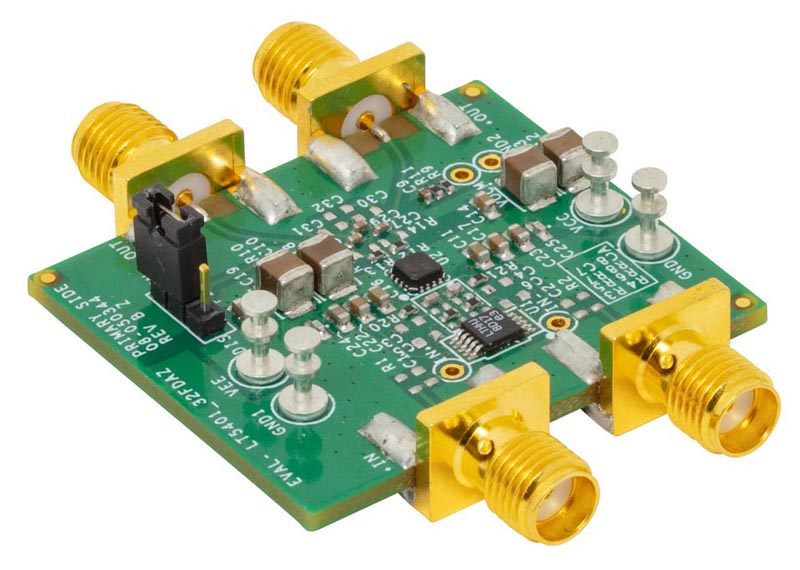

The LT5401 Evaluation Board
The LT5401 Evaluation Board.
