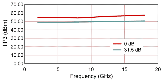

IIP3 vs. Frequency for the PE43610
IIP3 vs. Frequency for the PE43610.
