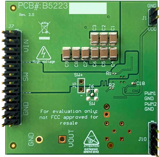

Development Board
The EPC9098 development board is a 170 V maximum device voltage, 25 A maximum output current, half bridge with onboard gate drives, featuring the EPC2059 eGaN FETs. This 2” × 2” (50.8 mm × 50.8 mm) board is designed for optimal switching performance and contains all critical components for easy evaluation of the EPC2059.
The EPC9098 development board   The EPC9098 development board
The EPC9098 development board.
